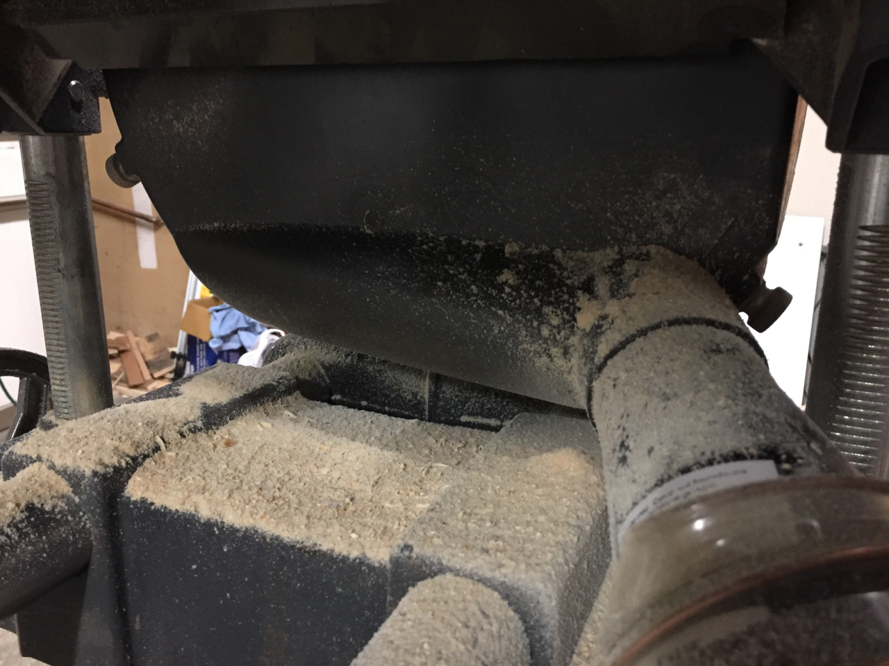

Pretty new to the Shopsmith (only had mine for a couple months). Is this normal for the amount of dust with a dust collector running? This is the picture after ripping 10-15 one-foot boards.
- IMG_5138 (2).jpg (1.17 MiB) Viewed 20446 times

From your picture it looks like the lower saw guard is not adjusted correctly leaving a gap near the top of the table. The two knurled nuts on the front and back of the saw guard (shown in your picture) need to be loosened and the lower saw guard needs to be adjusted to the right of the saw blade as far as possible. This should close the gap between the lower saw guard and the top of the table. This should greatly reduce the sawdust as shown in the picture. There are still other places for sawdust to escape around the Shopsmith saw guard. With the tilting table design there are some tradeoffs to it unfortunately. The thread linked below has some of the previous good discussions for ways to minimize sawdust escape around the saw guard:Meng88 wrote:Pretty new to the Shopsmith (only had mine for a couple months). Is this normal for the amount of dust with a dust collector running? This is the picture after ripping 10-15 one-foot boards.

A little confused, so for clarification...are you saying have the guard as “open” as it can me?

Definitely now right. As has been said, I believe the lower saw guard is either broken or improperly adjusted. I suggest you loosen the two knurl nuts and close the guards as far as they will go. I hardly ever run mine any other way (cutting dadoes or table tilted the exceptions).

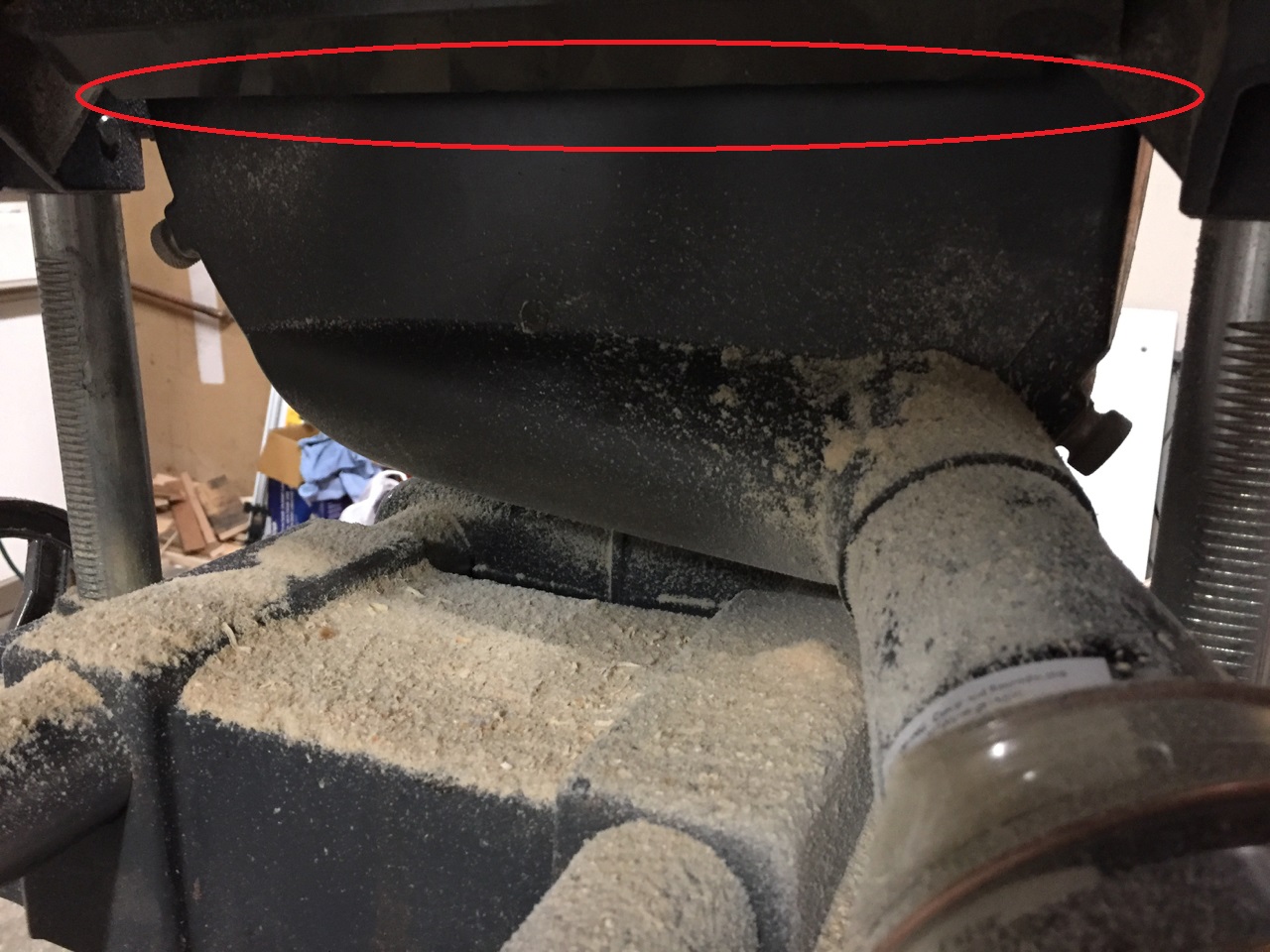

If you look at the area in the red circle of the pic below, it looks like about a 1/2" gap between the lower saw guard and the table above. This is where your sawdust is falling through. You may have to kneel down and look up at this area to see the gap.Meng88 wrote:A little confused, so for clarification...are you saying have the guard as “open” as it can me?

Oh! When I put the blade and guard on, I assumed it needed to adjusted as close to the blade as possible. Never thought to look under to see what it “seals” up against. I’ll give it another try later, but I’m assuming this is the cause.

I am waiting to see the results on this suggestion. I have that gap, too. It is inherent with the lower saw guard.RFGuy wrote:If you look at the area in the red circle of the pic below, it looks like about a 1/2" gap between the lower saw guard and the table above. This is where your sawdust is falling through. You may have to kneel down and look up at this area to see the gap.Meng88 wrote:A little confused, so for clarification...are you saying have the guard as “open” as it can me?
