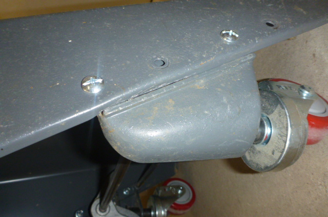

I had fitment issues with the caster bodies not fitting onto the edge of the sheet metal legs. As I moved the bodies upward to accommodate the larger wheels the edge didn't fit nicely into the body. I used a little persuasion to permanently adjust the edge so it would fit. Did anyone else encounter this? Perhaps the ball pein hammer wasn't the most elegant but I really didn't care, the resale is so low I might as well make me happy, not my heirs....
Two different caster bodies on two different Shopsmith legsets. Look closely and you'll see the sheet metal has been adjusted:

Re: ShopSmith Caster upgrade issues?
Nope. I did not have that problem with the three sets that I have installed.
I have one set yet to be installed. When I get that task done I'll try to remember to post my update.
I suspect that patience and finesse rather than a hammer might have been the better tools to use. OR: Maybe a rat tail file in the newly drilled holes.
