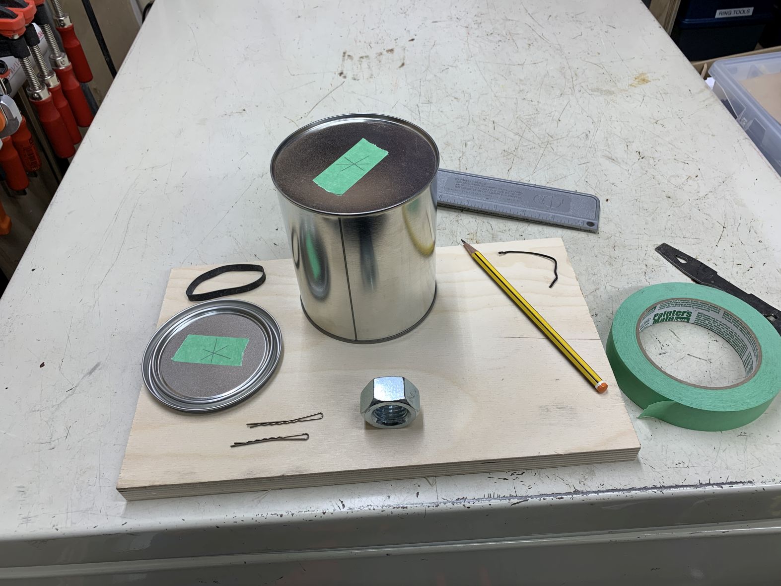

You can use just about any can but since I was doing three of these as gifts for grandchildren I wanted them to neat and clean so I went to Lowe's hardware and got paint cans. I also made one out of a peanut butter clear jar so you can see how it works, you know the "Magic".

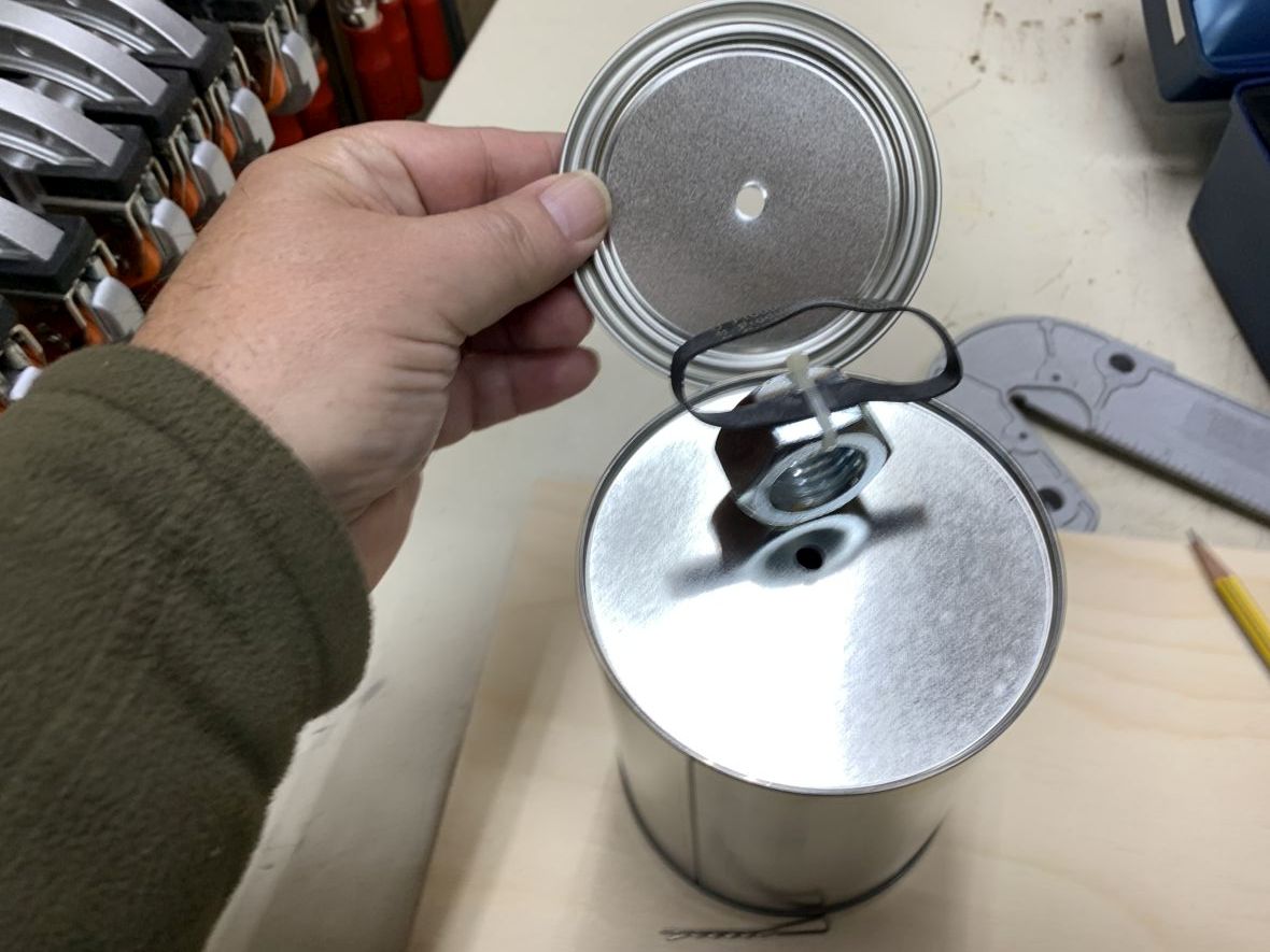

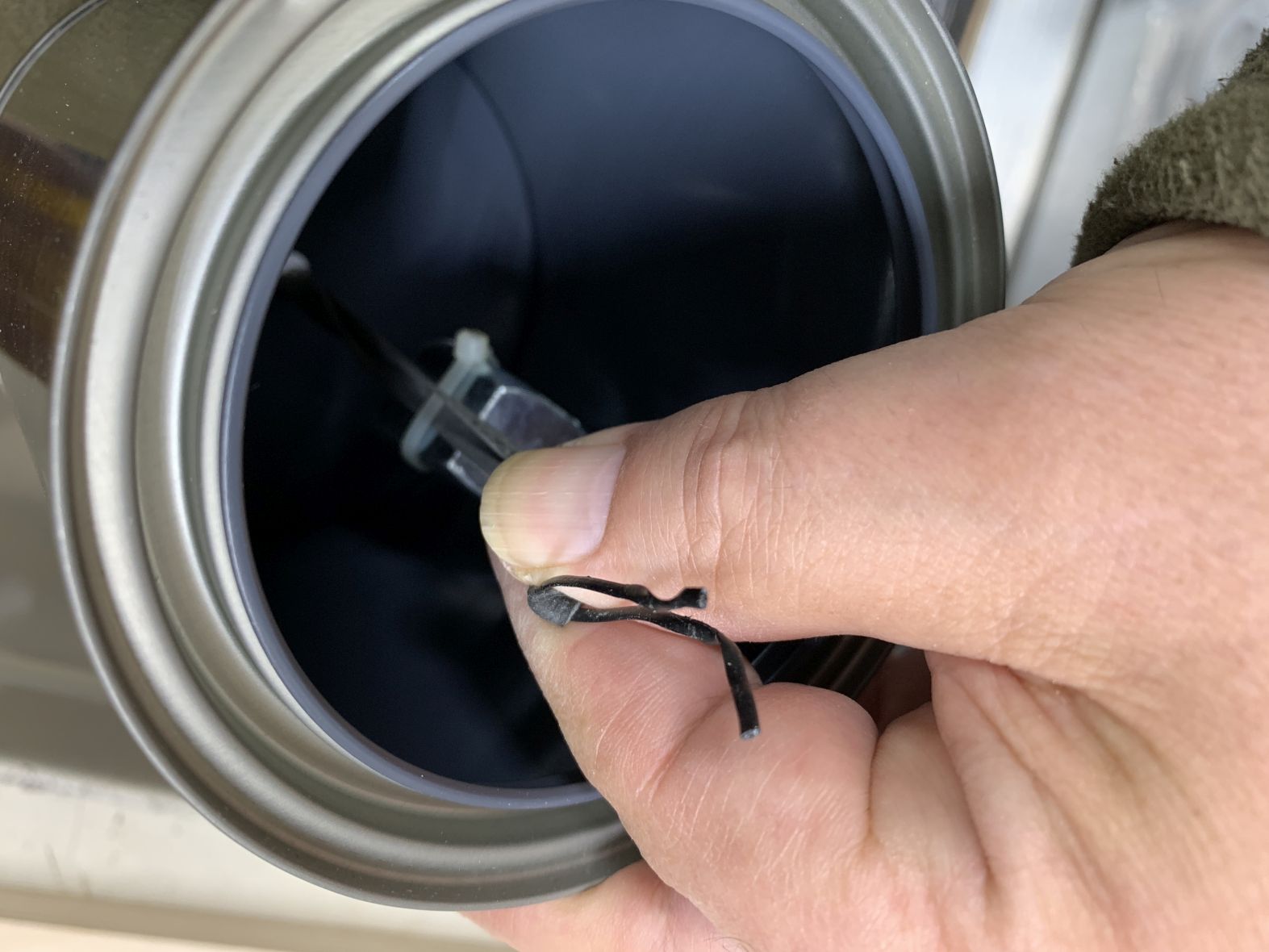

I used a nut but other weights will work. Here is a shot of most of the parts you need. I was going to tape the nut on but changed my mind and went to a zip tie. The tape was still used to mark the center of then ends of the cans.

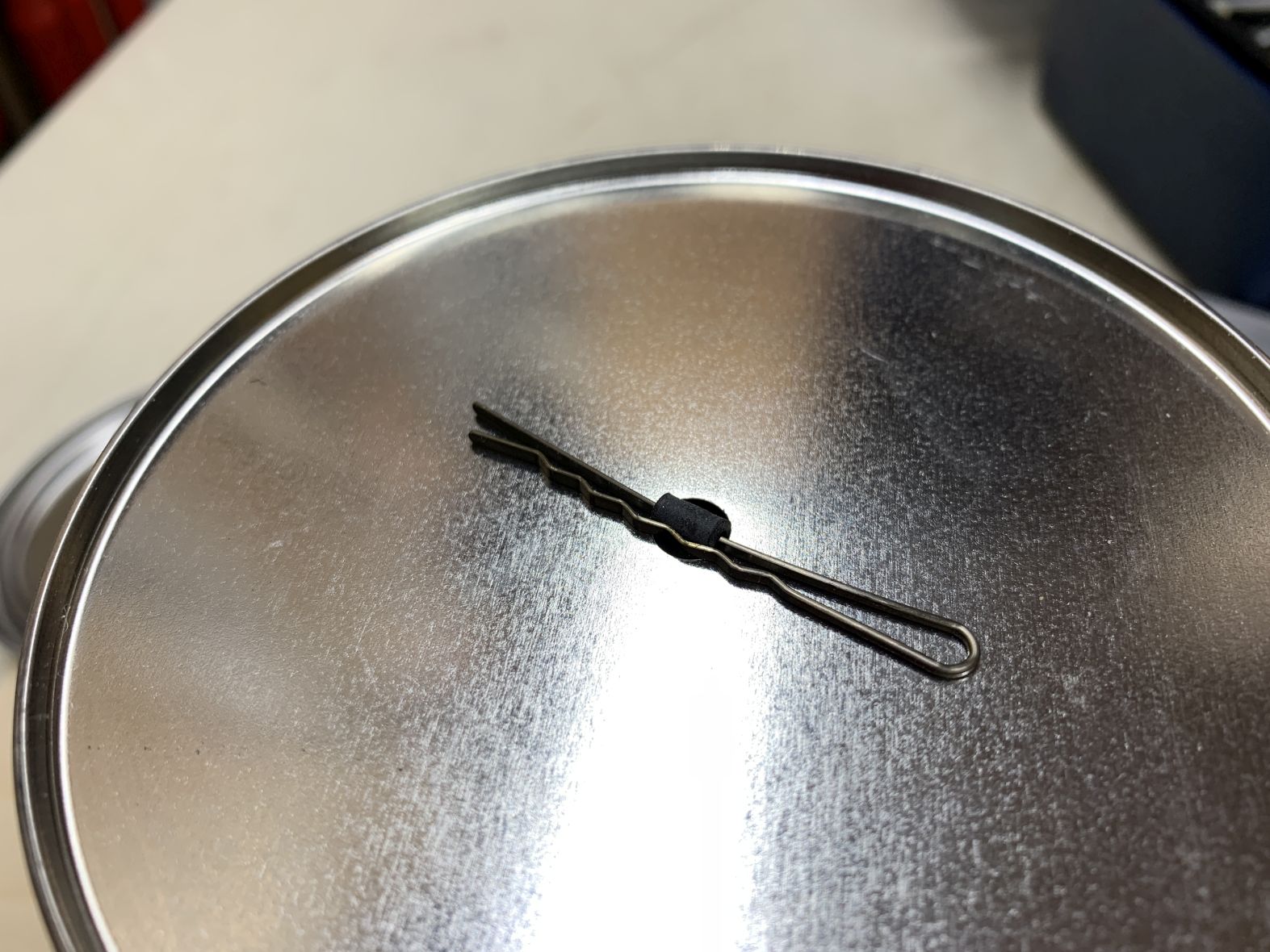

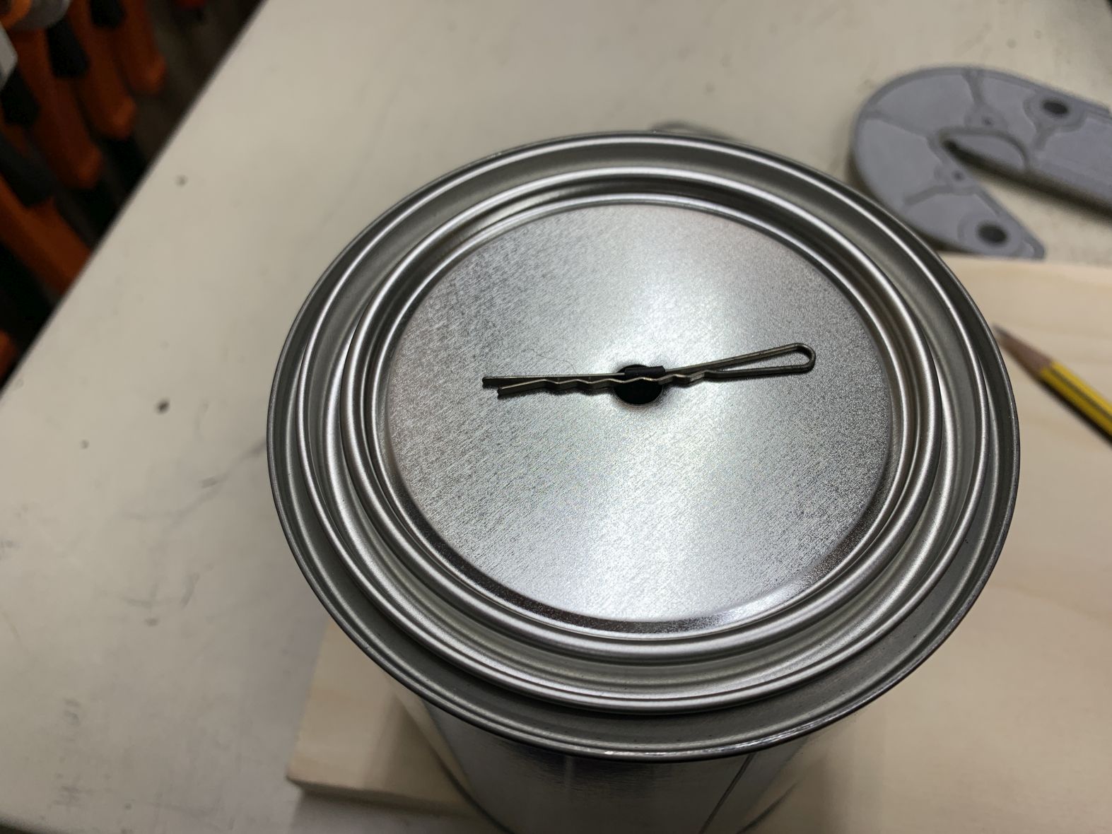

The following are a few shots of the assembly details not that you will need them since it pretty simple stuff:
And while I only got to see one grandson play with his it was a big hit. It got a lot more use and play time then anything else at the birthday party.
The rubber bands do wear out so expect to have to replace them from time to time.
