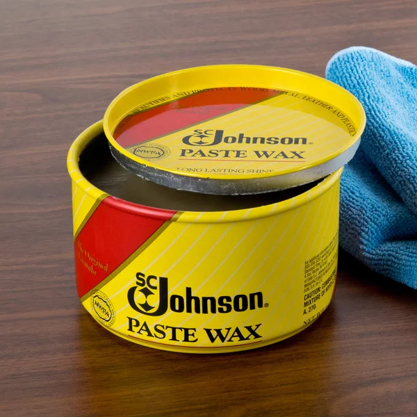

Does anyone have a good lubrication chart and/or what type of oil to use on it? The quill in the headstock seems to move with ease and has a very light skim of oil on it.

"Oil" bad. "JPW" good.
Johnson's original paste wax.

I am not sure what it is, so it could be JPW. What does JPW look like when it is coated?
Do you use JPW on the quill and the rails or just the quill/headstock?
Re: Introducing ER#38615
jstaley wrote:I am not sure what it is, so it could be JPW. What does JPW look like when it is coated?
Think shoe polish.* Shiney but does not rub off.
Use on anything that rusts, slides etc..
* Carnuba wax.

Ahhh I see. Thanks for that. Would not have known to look for that.

Post by everettdavis »
JPW
