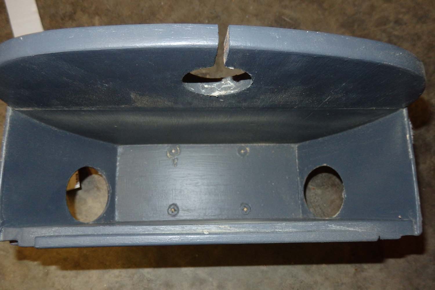

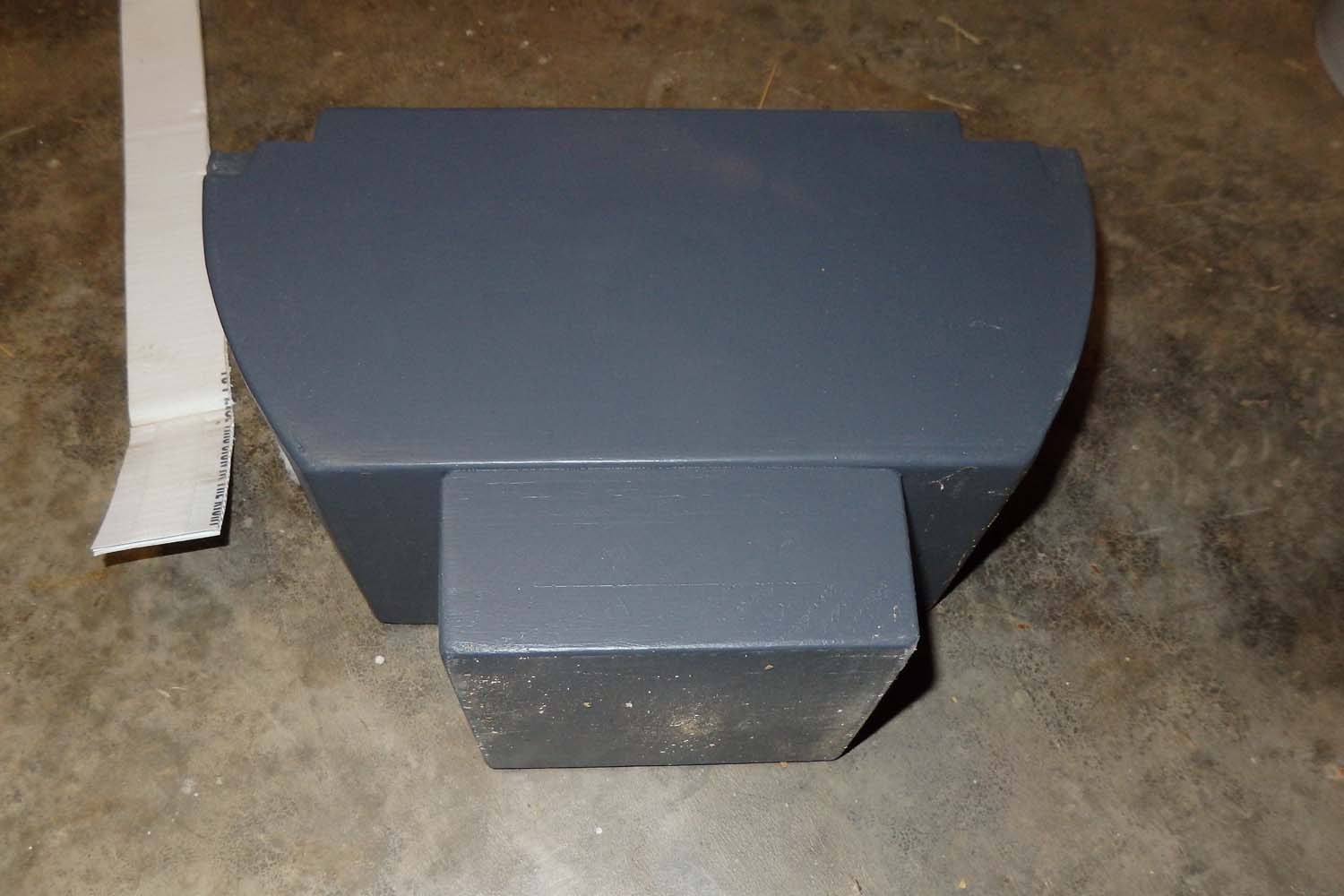

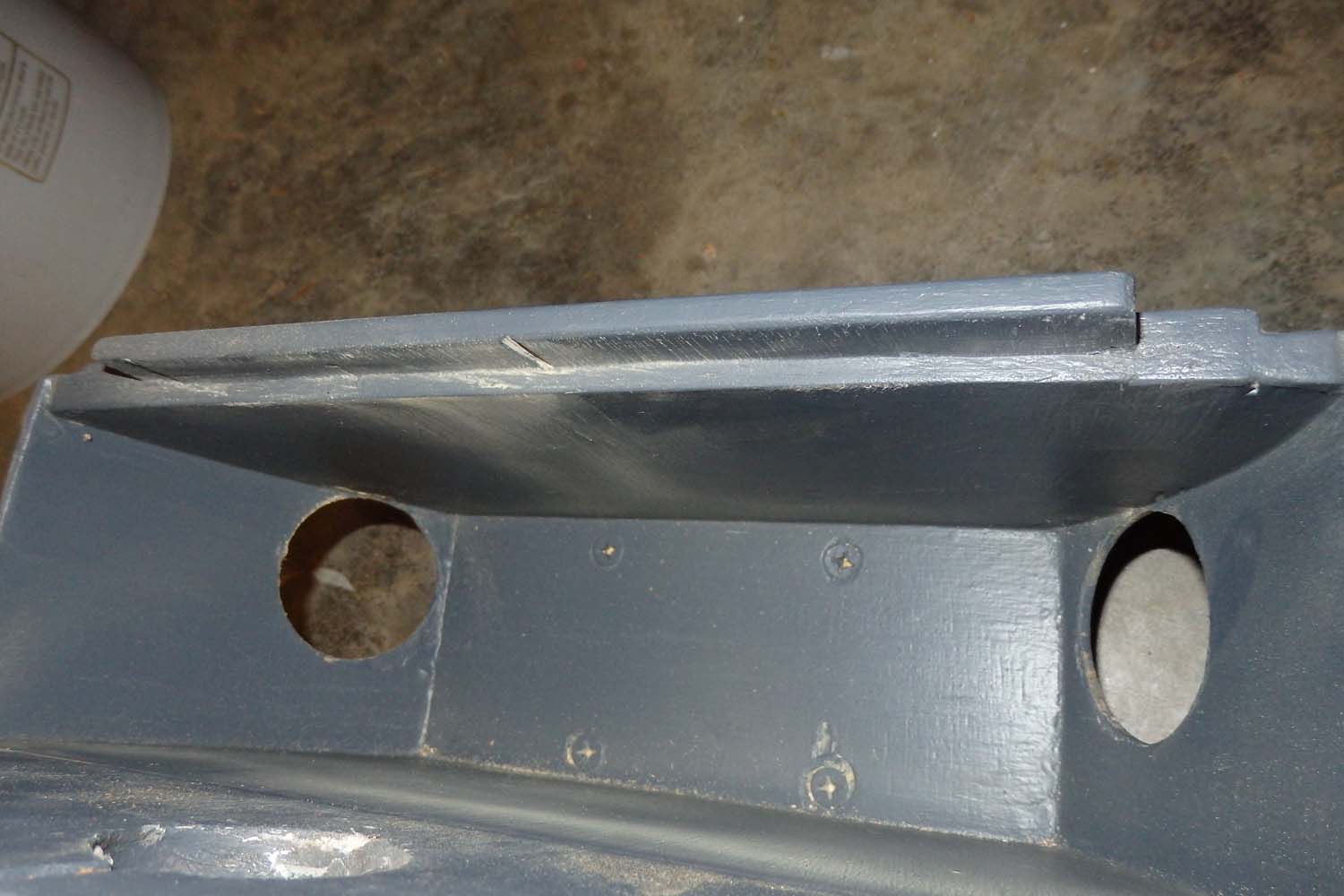

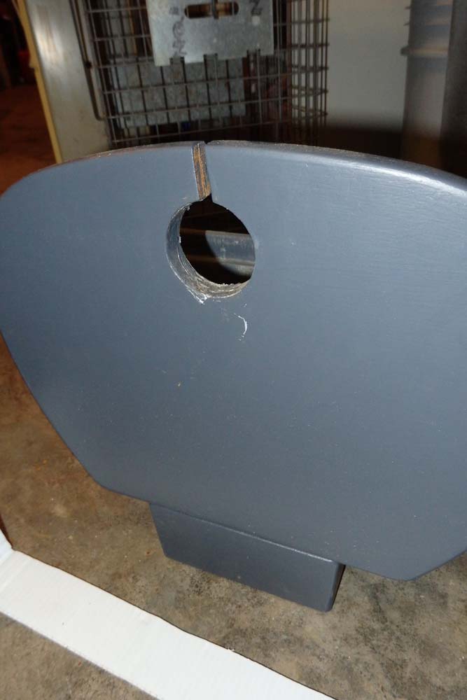

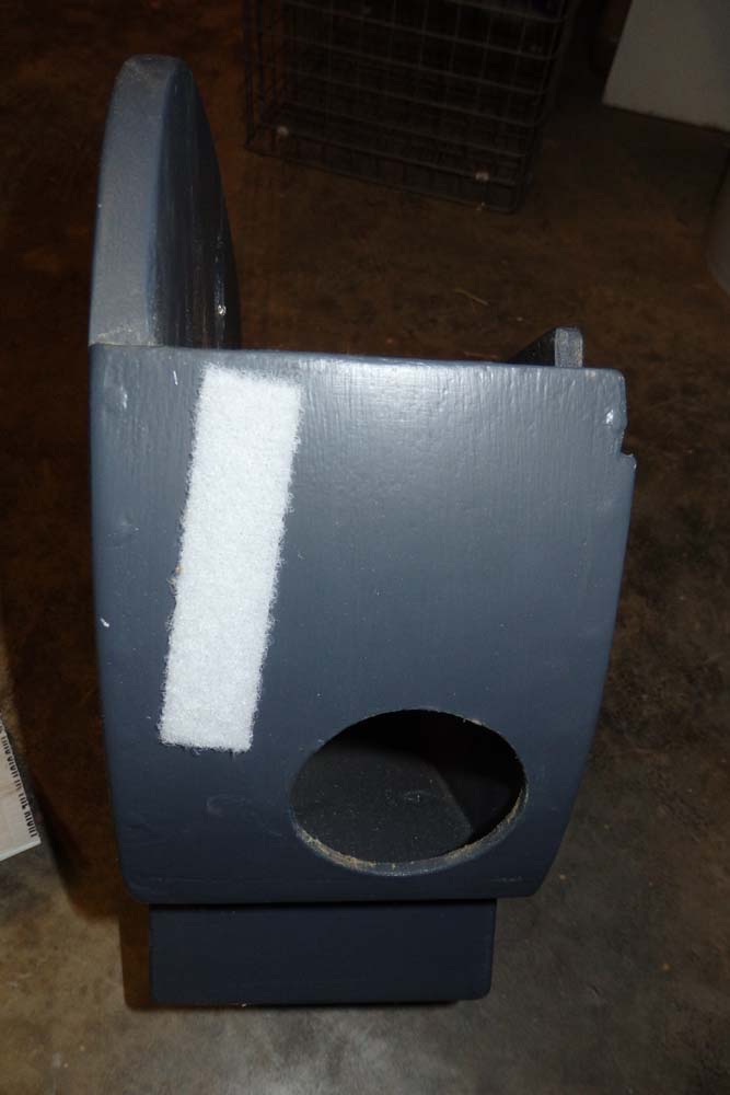

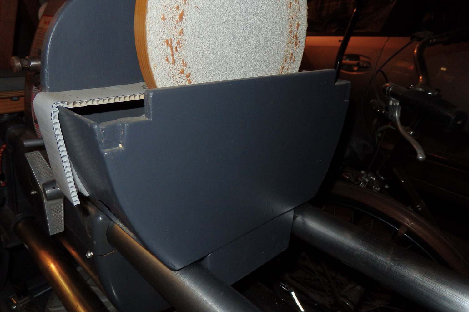

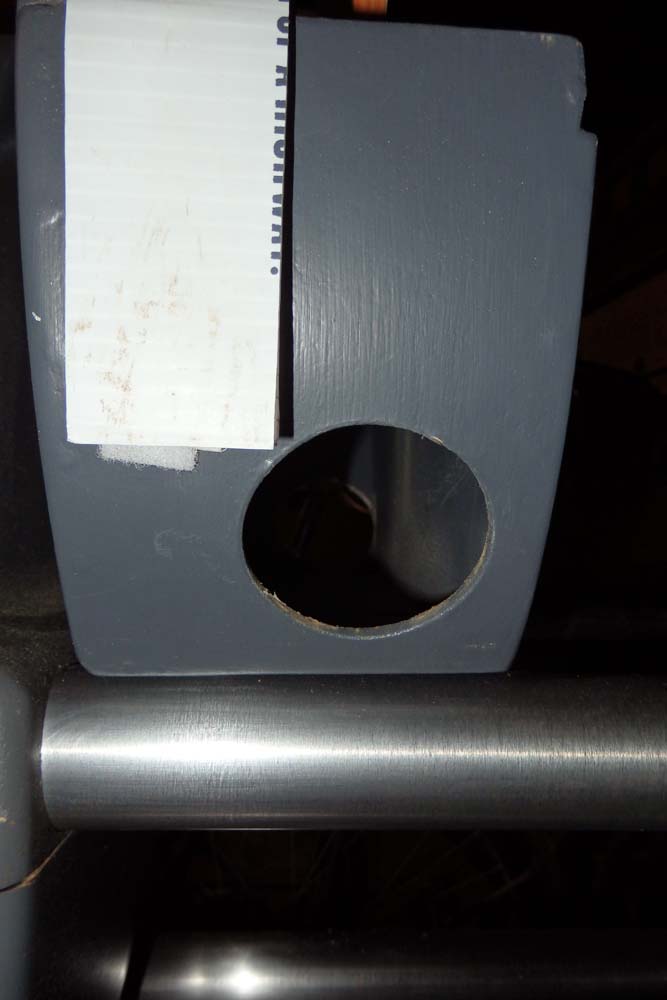

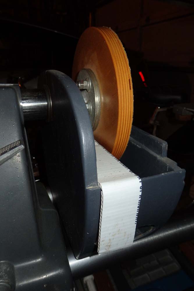

I have only used the 500 table and setup. While no guard was made (or is necessary) for using the 500 (or Mark V) in disk sanding mode, I made a "guard" that is more for dust collection than for safety. I modeled it after the saw guard, but made it larger to accommodate the 12" sanding disk, and have openings at front and rear into which dust collection hoses friction fit. The improvement in dust collection is considerable, considering the fact that normally there is no way to collect dust while disk sanding on a 500. Sanding is still done off the left edge of the table. Since the chute isn't easily tightened around the quill housing like a saw guard, I added blocking on the bottom to fit snugly between the way tubes. The sides are 1/2" plywood, with some notching to fit the underside of the 500 main table. The curved portion was fairly thin masonite (I think).

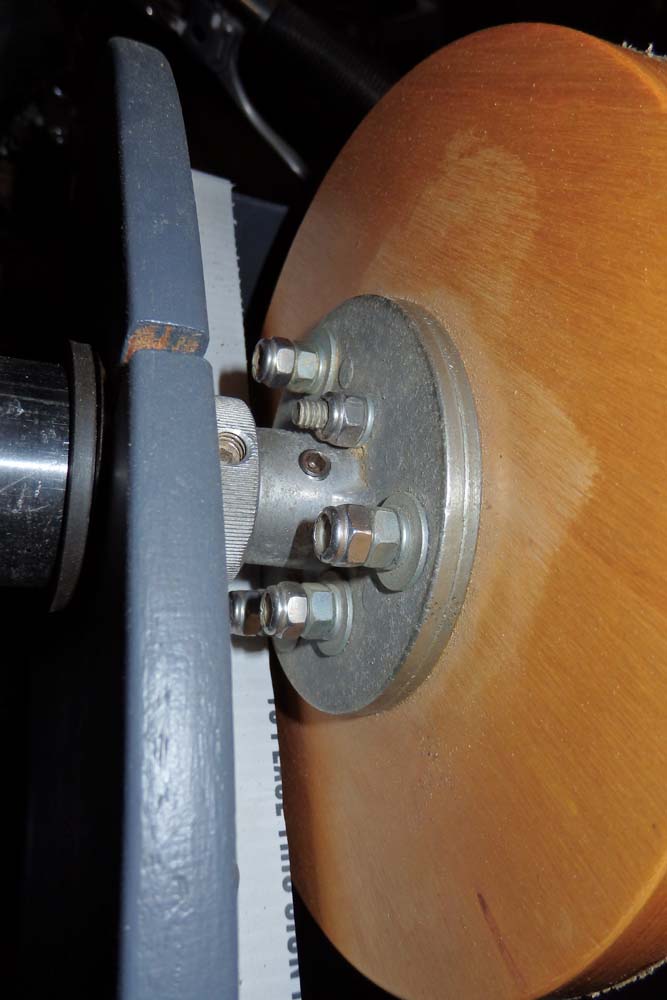

I use the disk sanding function frequently with a home-made 8" sanding disk ... 3/4" birch plywood mounted to a small lathe faceplate. I chose 8" because I could find 8" PSA sandpaper in a coarse grit (36). When I need fast stock removal, the 36 grit works great, and 8" has proved to be large enough for my needs. When I use the 8" disk, I use a strip of a corrugated plastic yard sign material hook-and-loop fastened to the chute to help close off the space behind the disk for improved dust collection. For use with the 12" disk, no closure piece is necessary.
