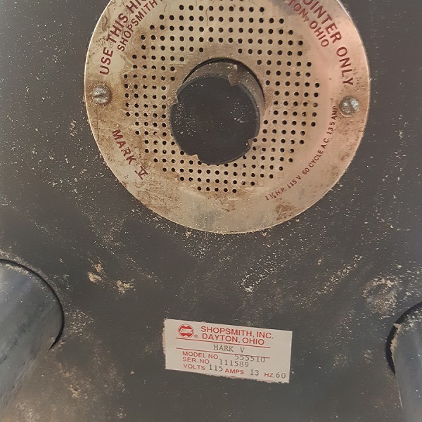

If the Serial Number is SS-111589 than it would have been made in December 1981 and later upgraded to a Mark V 510. If it does not have the SS prefix in the Serial Number than it is a Date Code and JPG is correct. Either way it is a Mark V since the Mark 5 labeling on the machine was changed to Mark V between January and March 1980. Also the Date Code/Serial Numbers are printed on a sticker whereas the Serial Numbers are stamped on the lower edge of the Belt Cover Vent Plate.

If you get a second to snap a photo and size it down to fit in the forums, please take one of the serial number and we will know for sure.
From your description it sounded like there was an upgrade to the 510 by the buyer you sold it to, as your comment suggests you noticed the differences when you bought it back.

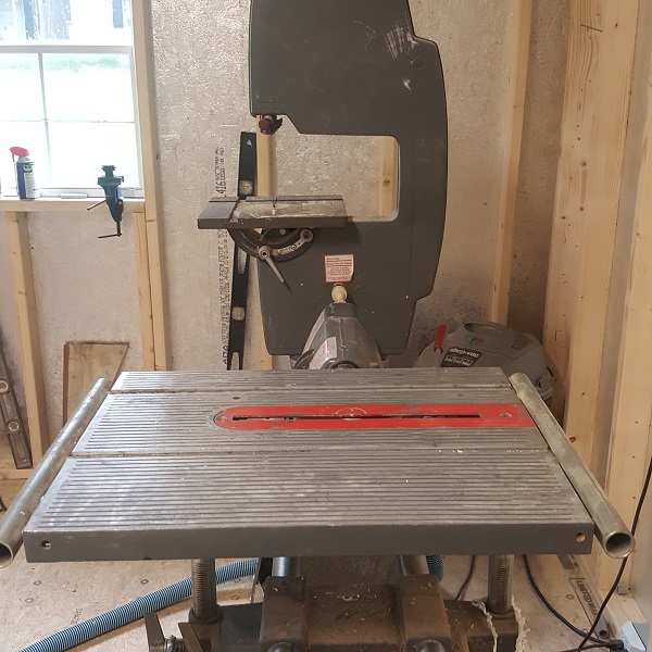

Re: Cant believe my '81 model mark 5 still runs like a dream
Couple of Pictures. I love a good mystery!
Mystery solved!
It is a Mark V 510 made November 15, 1989
