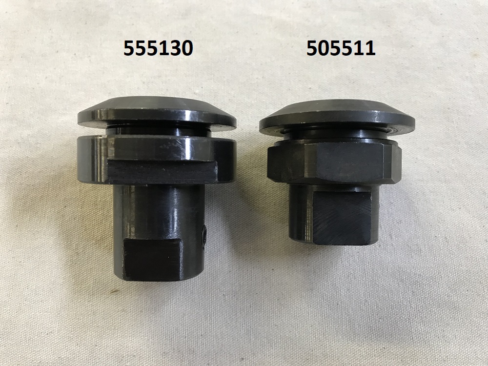

Is the saw blade closer to the quill or further away? Using the arbor for the original (500) table system would cause it to be about a 1/4" closer but the blade would hit the retracting part of the lower guard. The 1-1/4" and 5/8" Saw Blade Arbors for the larger (510/520/M7) and original (500) table systems are about a 1/4" different. If it is further away from the quill there must be something out of place. Is the upper guard going into the lower guard correctly? Is the lower guard mounted on the quill directly against retaining ring? If the bumper ring is between the retaining ring and the guard it will move the guard about an 1/8" causing the blade to be closer. Is the arbor going all the way on the spindle? Is the spindle Knob all the way on? There should be about an 1/8" between the end of the tapered flat and the Spindle Knob.

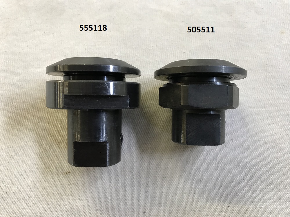

Just for reference this picture is the 1-1/4" Saw Blade Arbors for the 510/520/M7 and the Original Mark V 500 Table systems.
555118 - 505511 r.jpg (275.91 KiB) Viewed 20375 times
EDIT: I was looking at something this morning and the above picture caught my eye. :eek: I had mislabeled the Arbor on the left as 555118 instead of the correct part number of 555130. :o Below is the corrected picture.

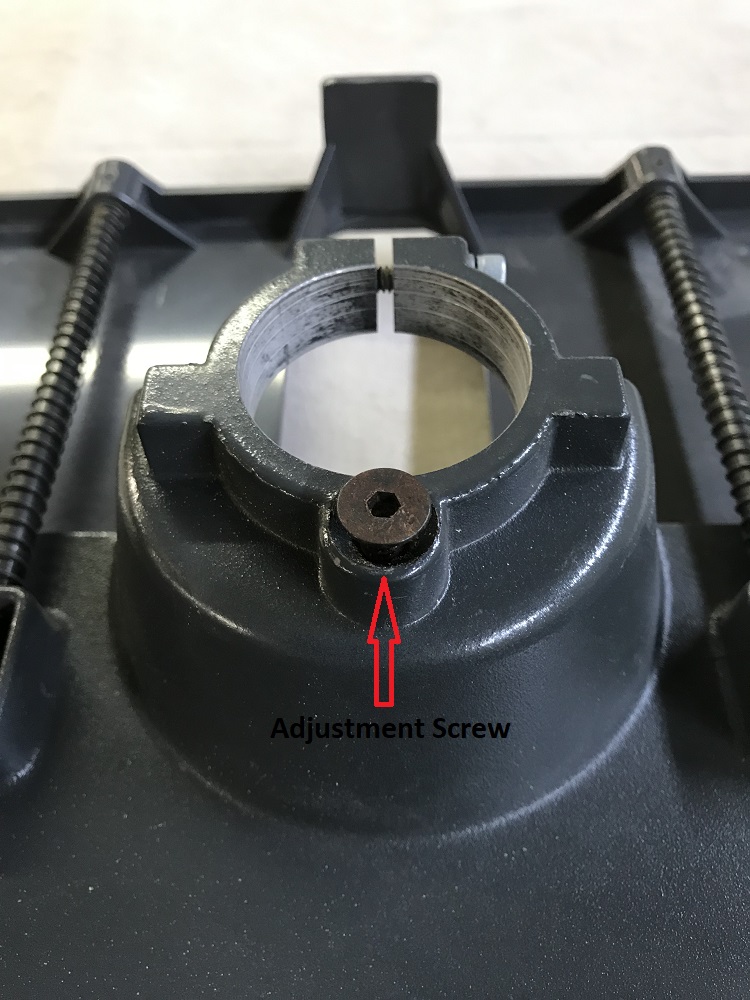

It is true for the Mark 5/V 500 with the Original Table System but not so much for the 510/520/M7 Larger Table System. JPG has owned his Mark 5 Goldie since new. He has seen a number of changes in the Blade Guard Systems over the years. With some of those, table position affects the Upper Guard's alignment since there are Upper Guards that mount to the Table not the Lower Guard. There is only one version of the Saw Blade Guard that has been made for the Larger Table System of the Mark V 510/520 and Mark 7. The correct components assembled correctly align the Blade and Blade Guard. Table position does not effect the alignment of the Guard to the Blade, only the position of the Blade going through the table slot, unless somehow the table is pushing against the Guard. With that being said there is an adjustment screw on the part of the Lower Guard where it clamps against the Quill's retaining ring which is for some fine adjustment to the Lower Guard's position on the Quill. Sorry I neglected to mention this before. This can move the Lower Guard up to about a 1/4" away from the Headstock. This will also cause the Splitter of the Upper Guard to move to the right of the Blade. In the picture below it is screwed out but I have it in all the way for proper alignment on my Shopsmith during use.
510-520 Guard back.jpg (211.83 KiB) Viewed 20290 times

I adjusted screw to move the lower guard housing away from the head and it lines up, now. I find it odd that a standard blade does not line up with the guard. The lower guard is now partially on the retaining ring but feels secure. I will be cutting some cedar today and will see how it goes. I am making a trellis.
