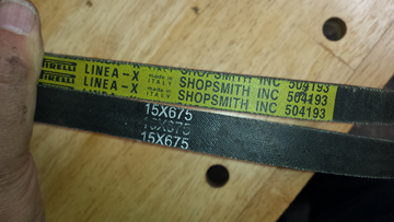

I'm relatively confident that someone on this forum has posted something like this before, but for the benefit of newbies like me: It matters where you buy your belts. Sources clearly have different ideas on the belt specs, particularly the V-belt.
Here's a comparison of two V-belts I bought via Ebay. The first I got was a no-name from Bandsaw Tire Warehouse, the second a Pirelli from a private seller with relatively low feedback. Both specified that the belts were specifically for the Smith. The BST belt came in 5/64 wider. It was a struggle to even get it on the sheaves, and it just felt wrong. I'm sending it back.
Belt compare.jpg (83.2 KiB) Viewed 31440 times

StevenAyres wrote:I'm relatively confident that someone on this forum has posted something like this before, but for the benefit of newbies like me: It matters where you buy your belts. Sources clearly have different ideas on the belt specs, particularly the V-belt.
Do NOT do that!
16 x 67.5 is VERY close to original SS design which was about 1 9/16 x 26.5. Indeed it is closer to anything else out there.
Be aware that most belt manufacturers design to metric dimensions. In addition they seen to think slightly narrower is "ok".
The belt width has a direct effect on the resultant speeds attained with the SS reeves drive.
It has been observed in the past that recent SS Inc belts are slightly narrower.

JPG wrote:16 x 67.5 is VERY close to original SS design which was about 1 9/16 x 26.5. Indeed it is closer to anything else out there.
I'm perfectly willing to accept that the spec numbers match. But in practice I can't get it installed, where the new Pirelli went on just fine and works as it should as far as I can tell.
I admit it's been a very long time since I changed a belt, so I tried the wide belt again this morning on the other headstock. I can get the belt on both sheaves, but so far I can't get the upper closed far enough to install the speed control.
I hate to rehash a topic that's probably long on this forum somewhere, but am I doing or understanding something wrong?
How much do you mean by "slightly," above? Is my Pirelli belt too narrow to make the right speed range?

Not knowing the actual dimensions of the pirelli belt, I cannot say. Do realize that the reason for letters rather than speed calibration on the speed indicator dial is because there are so many things varying including the belt width being one of those things.
I dare say +- 20% would not be unusual especially with worn belts.
FWIW a narrow belt shifts the speed range upward whereas wider belts shift the speed range downward.
I really think you are better off with the BTW belt. As it wears the speed attained for a given setting will increase slightly and will be closer to 'nominal'. :cool:
P.S. all other things being equal, the BTW belt will ride higher in the motor pulley perhaps even slightly beyond the OD.
With narrow belts, the high speed limit setting becomes more critical, with wider belts less so.
High speed limit adjustment is not typically needed nor something to fret over. :)

I'm pretty confident I'm doing what you describe, the standard procedure in the manual. I can get the belt onto both shafts, but only with both sheaves wide open, the motor sheave up against its spring limit and the idler sheave open beyond the range of the speed control. (Note: I'm doing this on the Mark VII, but my experience was the same on the 5, just with a couple more gears in the mix.) I can't see how to make this work.
Could the belt be the right width, but too short?
JPG wrote: Not knowing the actual dimensions of the Pirelli belt, I cannot say.
The Pirelli belt is 48mm (31/64"), same as the one running on my low-mileage VII.
JPG wrote: High speed limit adjustment is not typically needed ...
I notice there's a simpler provision for that on the VII, fwiw.

OK It ain't gonna work on a MVII. :( The belts are not the same length!!! The shaft spacing is different. You need a belt 4" longer IIRC.
Yes the HS stop is far simpler.
Yes I also have tried to put a M5 belt on a MVII before I recognized the shaft spacing differed.

OK, bad test, doh!
I put the VII back together with the old belt (a nominal 51mm that's now about 49), and it's running at close to rpm spec.
Then I tried the BSW belt again on the brownie. I imagine that thanks to a couple days' practice plus the assurance that the much wider belt is correct, the procedure was less a struggle and it seems to have gone together OK. The head is running at around 400rpm at the low end. Yay!

Now: Can anyone tell me why "recent SS Inc belts are slightly narrower"? Is it due to differences between the older and current products?
Not quite that 'simple'.
For starters belt manufacturers seen to have gone metric and substitute metric belts for near imperial measurements.
Secondly until very recently belts in 1/2" length increments all but disappeared.
Also SS does not have the engineers that did the original design and have made poor procurement decisions in the past(I believe they did learn from that). Recent belts from SS seem to be correct(slightly wider than 1/2").
FWIW, BTW is not the only one touting the metric belt(15x675 = .590x26.57).
