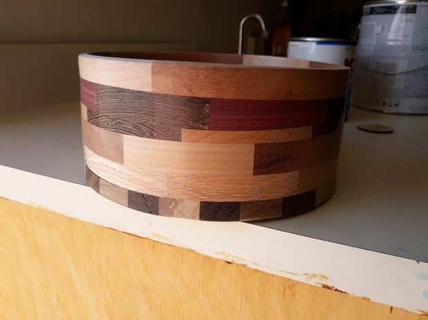

Re: slanted board for power sander
bowl is done.
results: so so.
I think I need more of an acute angle.
The sanded layer didn't fit as nice as usually, perhaps my jig was "soft".
The next one will be a little bit more thought out with heaver wood.
anyway here it is:
results: so so.
anyway here it is:
made a new jig with a better angle.
please with the results, but not as great a look as I thought.
Most people won't even see it.
Anyone who 'matters' will notice!
NICE!!!!
NICE!!!!
Farley,
Glad that the concept works. I wonder if a stronger light/dark and/or color difference between layers would help, plus still might need more angle. I'm sure a large part of is it the shading in the photos, but I can see the slant better in the first than the second. I think the piece of spalted (maple?) on the top piece helps me better see the angle. Good progress on an interesting technique!
Roy
