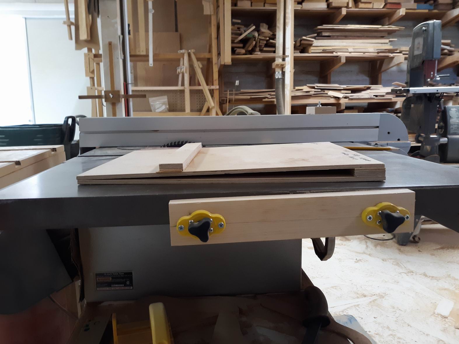

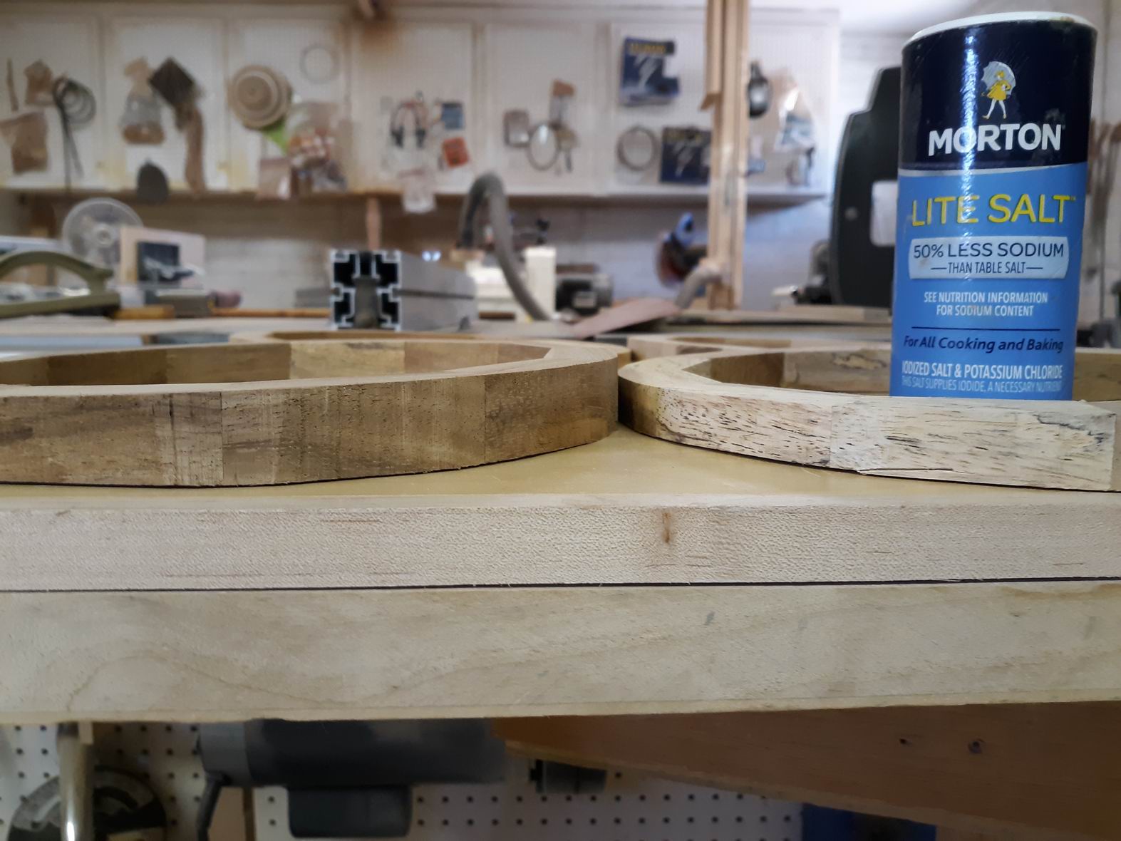

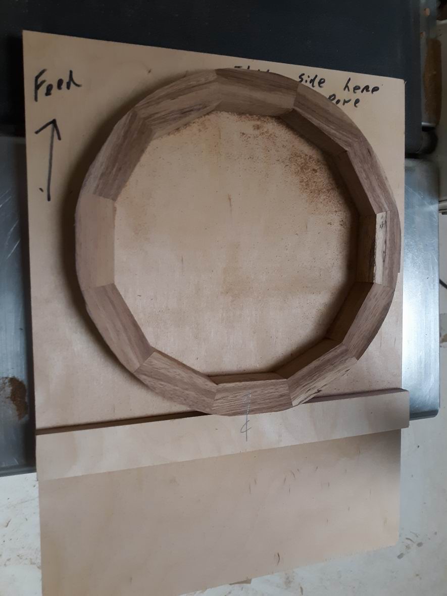

so a quickie jig and the results are good.
the idea works.
I'll use the four segments I made and post a finished pix when done.
next jig will have a hinged end and some kinda movable space at the other end to give me more angle when wanted.
the salt in the pix is to show what I use it when clamping my segments together. Just a few drops and it prevents the segments from moving apart when clamps are applied. the salt dissolves leaving no gaps.
sorry the pix are so big, couldn't figure out the size SS accepted.

Re: slanted board for power sander
Posted: Sun Jun 02, 2019 4:56 pm
by roy_okc
Excellent first version.

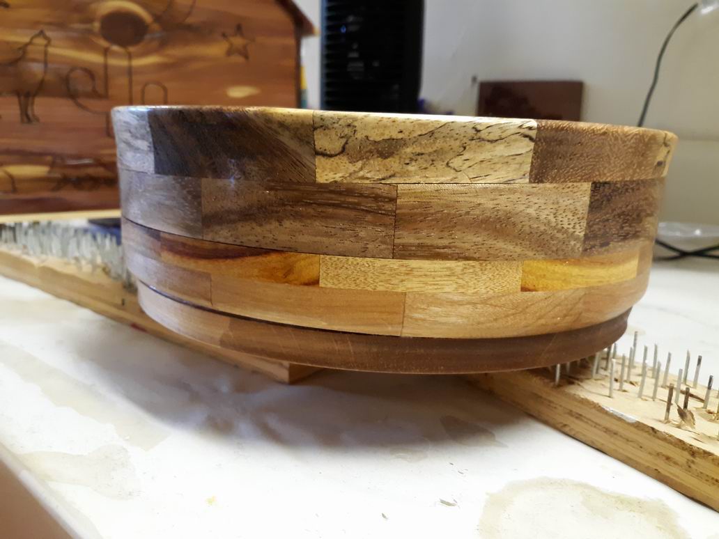

Posted: Mon Jun 03, 2019 8:06 pm
by farley
bowl is done.
results: so so.
I think I need more of an acute angle.
The sanded layer didn't fit as nice as usually, perhaps my jig was "soft".
The next one will be a little bit more thought out with heaver wood.
anyway here it is:
- finished bowl.jpg (87.14 KiB) Viewed 28060 times
Posted: Sun Jun 09, 2019 6:05 pm
by farley
made a new jig with a better angle.
please with the results, but not as great a look as I thought.
Most people won't even see it.
Posted: Sun Jun 09, 2019 9:57 pm
by JPG
Anyone who 'matters' will notice!
NICE!!!!
Posted: Mon Jun 10, 2019 1:05 pm
by roy_okc
Farley,
Glad that the concept works. I wonder if a stronger light/dark and/or color difference between layers would help, plus still might need more angle. I'm sure a large part of is it the shading in the photos, but I can see the slant better in the first than the second. I think the piece of spalted (maple?) on the top piece helps me better see the angle. Good progress on an interesting technique!
Roy
