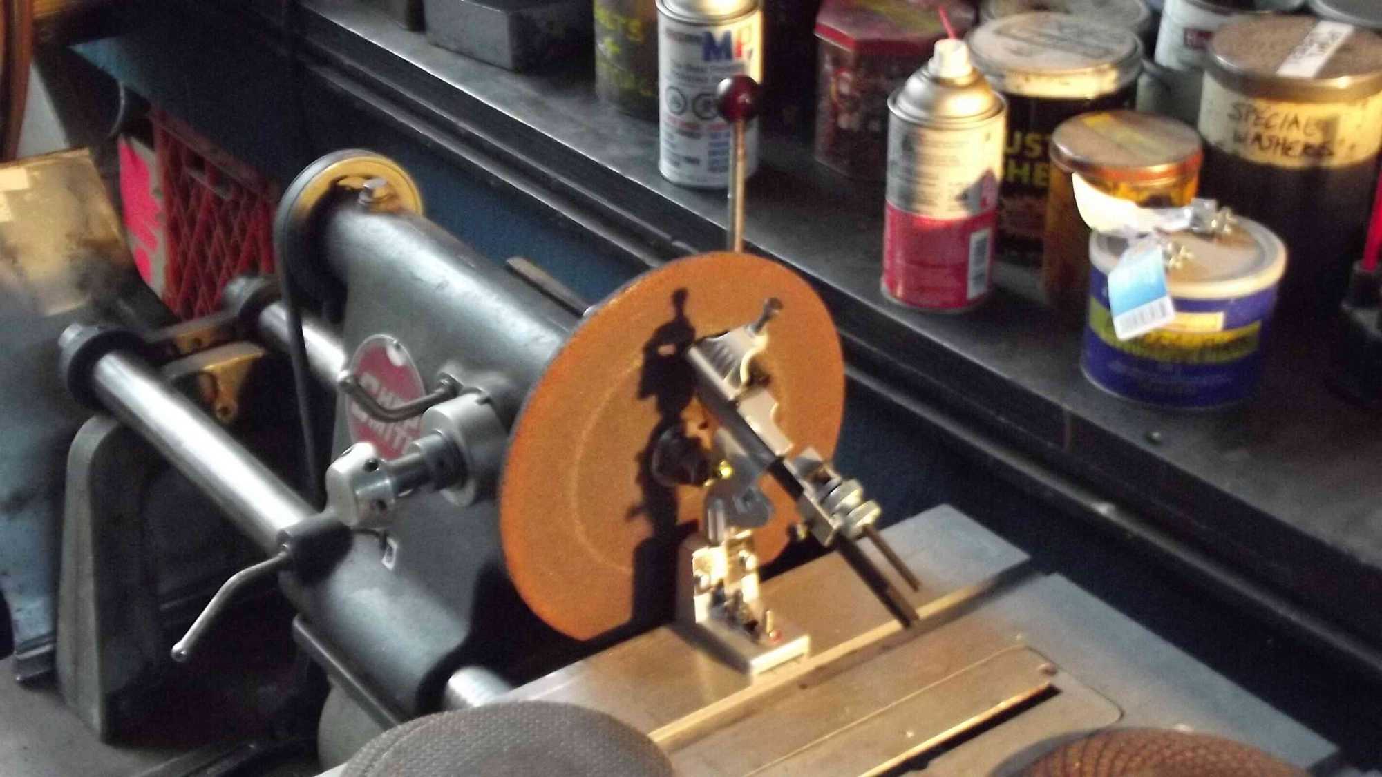

Today I mounted one of those drill bit sharpening rigs onto the table of the Shopsmith by drilling 2 1/4" holes.
I put them in the center and in line with the chuck -- could have offset them too I suppose.
I put one of those 8" thin stones in the chuck, but it seems to me it is too coarse a grit for bits.
That big sanding disk that came with has some nice emery glued to it.
Would be a nice finishing touch to the first cutback.
Sorry, I'll go take a photo now for your entertainment. :)

Any suggestions as to the best stone for bit sharpening?
Sharpener Mt'd_3.jpg (139.47 KiB) Viewed 29286 times

I do my drill bit sharpening on a Drill Doctor. I have the original model and it puts a superior edge on conventional twist drill bits. All of the other do-dads left an inferior edge and/or angle.
Bill V
Re: Drill Bit Sharpening
TooTall wrote:Sharpener Mt'd_3.jpg
Just about any fine grit 12" sanding disk will do.
NICE looking 10E!!!

My Smith came with emery cloth glued to the big sanding disk.
I'll have to try that.
It's an insult to call this a do-dad as though it's not much more than a gimmick. I almost sprung for a Drill Doctor but for under $30 I thought I'd give this a shot after watching a few videos.
There's a bit of an art to using this jig with success I'm thinking -- as opposed to plug-and-play for dummies. :)
