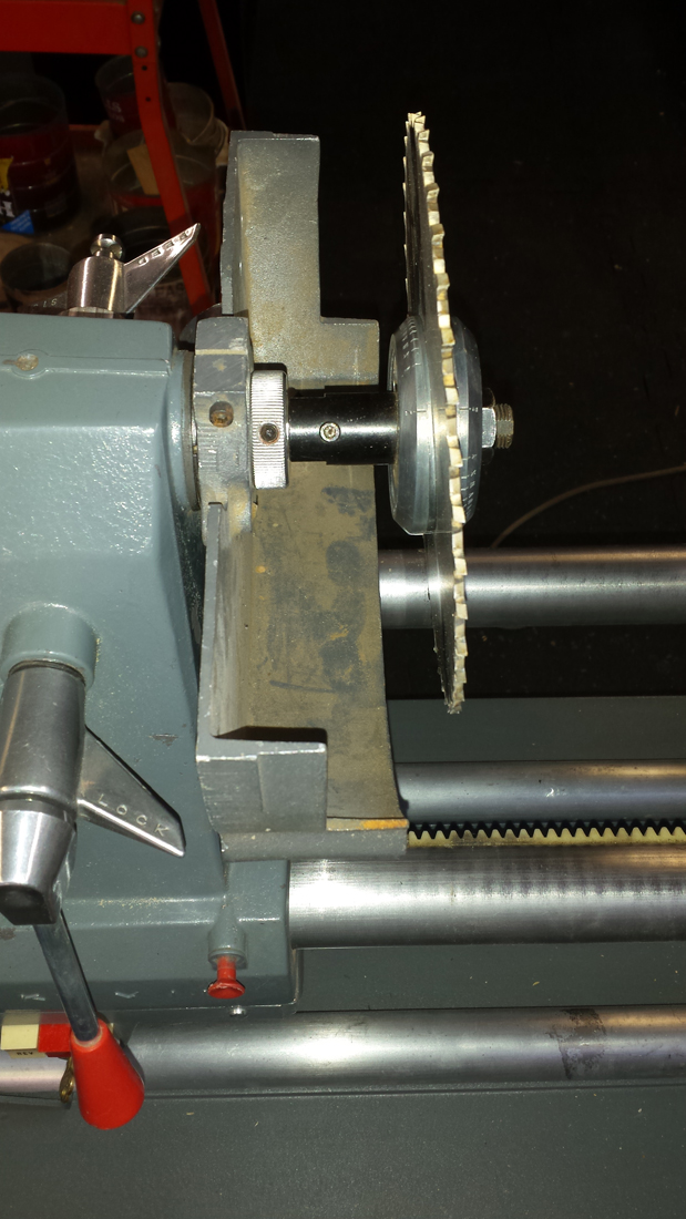

Is there a correct arbor for the Magna adjustable dado to fit the Mark 5, meeting the main table slot, with the Mark 5 lower guard? Mine seem to be an inch or so too long.
I have the 510 guard, but that won't work with the 5 or VII tables. Thanks!

Can you post a picture of your problem? That arbor should have enough movable spacers so you can line it up where it belongs.

The problem is that the arbor shaft is too long to fit the blade into the guard.
Guard problem.jpg (415.15 KiB) Viewed 24727 times
The Mark 5 guard fits the table system, the 510 guard doesn't. This works fine with sawblades and the early, stubby blade arbor, but not anything needing the 5/8" arbor.
The manual says widen the guard with a spacer. It looks like I'll need that.
I guess it's also possible to turn an adapter tube to push the guard out on the shaft, but that seems a little complicated.

rpd
Posts: 3045
Location: Victoria, B.C.
Re: Magna dado arbor
Post by rpd »
There was an aluminum spacer that used to be available for that lower guard, there are pictures in this post. https://www.shopsmith.com/ss_forum/view ... 65#p242865
The part # does not seem to be available any more, but it shouldn't be that difficult to fabricate something similar from sheet metal. :)

rpd wrote:There was an aluminum spacer that used to be available for that lower guard, there are pictures in this post. https://www.shopsmith.com/ss_forum/view ... 65#p242865
Perfect, thanks!
