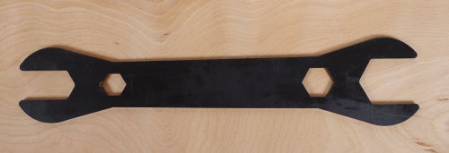

I am glad you were able to solve this and don't have the wobble now. I don't think I have ever seen this on my Shopsmith, but I have had the arbor nut slightly loose once or twice, so it is possible. I have always risked hitting my fingers on the sawblade and cutting myself when I tighten the arbor. I say this because I use the Shopsmith long arbor wrench (pictured below, item # 515979) with a mechanics open end wrench to tighten the arbor nut. Tightening the arbor nut is a bit awkward any way in trying to keep your fingers clear of the sawblade teeth. I had been thinking about ordering a second long arbor wrench to use for when changing sawblades out on arbors. After reading your posts, I think I will go ahead and buy a 2nd arbor wrench from Shopsmith. For me at least, it has always been a bit awkward to change sawblades using an open end wrench that isn't as long or wide as the Shopsmith arbor wrench to tighten against the Shopsmith arbor wrench. I think having 2 of these will give me more control to tighten the arbor hopefully without scraping my knuckles on the sawblade, but also be able to get it fully tight as well. I believe you have helped me make my decision to order a 2nd arbor wrench...

Understand and agree but I believe I have eliminated the awkwardness by always doing this with the arbor mounted on the drive shaft and using a large crescent wrench in conjunction with the arbor wrench.RFGuy wrote:TS,

Thanks Dusty. Yeah, I have tried it both on the driveshaft and off, but I didn't see much difference for me. I agree that if you have a long handle crescent wrench or similar, I think it makes it easier. The problem that I have is with my open end wrenches that I have on hand, they only go up to 7/8", so I use my 11/16" open end wrench which isn't terribly long (9") with the Shopsmith arbor wrench that is 13" long. I think having two identical type wrenches would be good for pushing in one hand and pulling in the other, but ideally they should be long handle wrenches, IMHO. The $18 for the wrench isn't really a problem, but rather the shipping that Shopsmith charges for everything.dusty wrote:

n my case I have 2 longer box / open end wrenches , one on the arbor I usually lay a rag on the way tube , then I set the wrench against the rag on the way tube, and the other I use to loosen the arbor nut , when tightening I just reverse the one on the way tube .
I was first concerned about damage to the way tube , so far it hasn't been a issue and I can get it good and tight.
