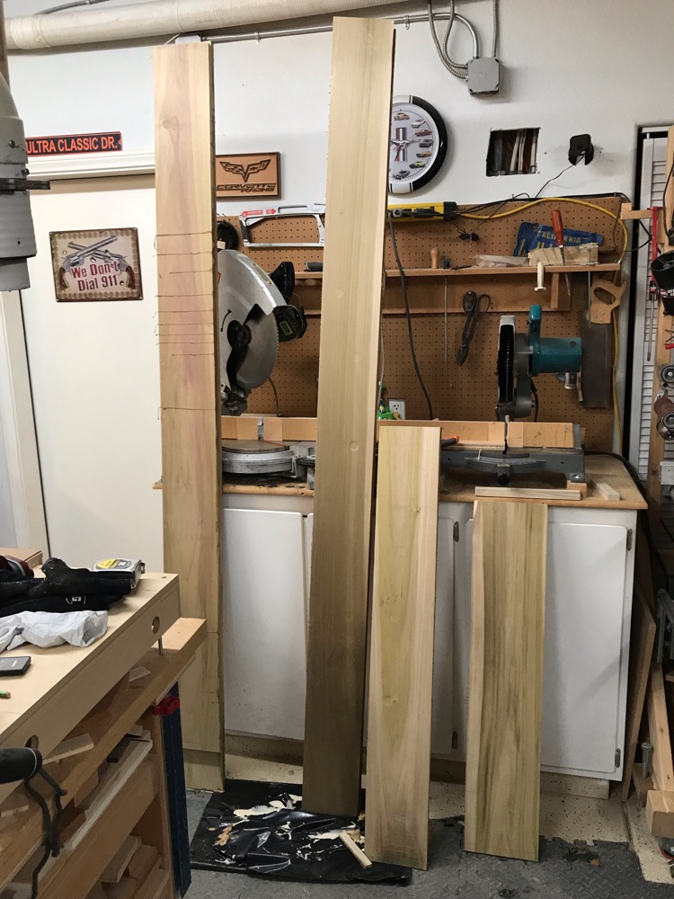

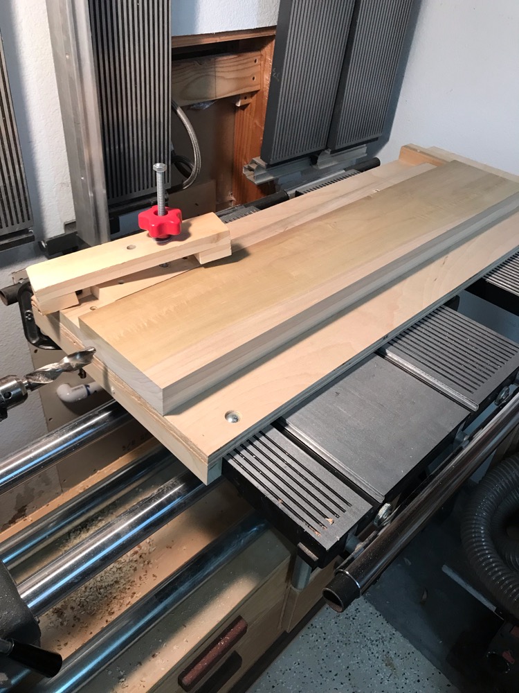

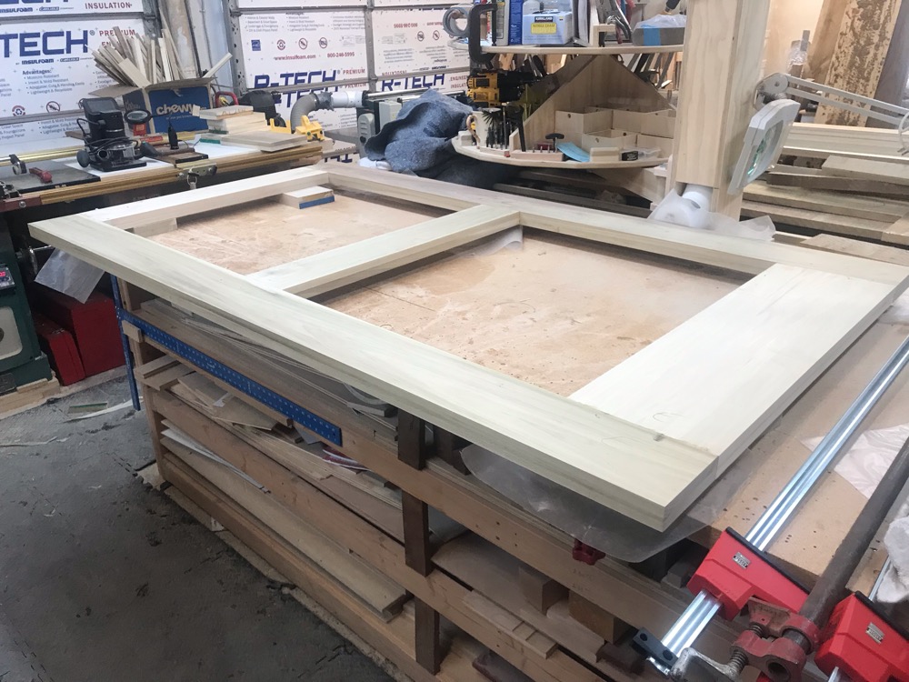

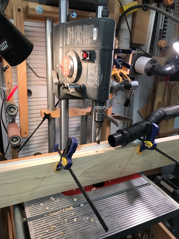

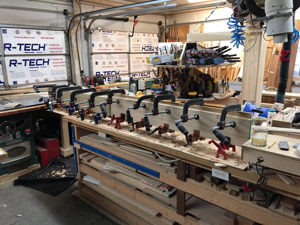

I started the next project for the house which will entail building six carriage doors for both garage door openings. The large double wide will have four doors and the smaller opening will be two doors. For the larger opening the doors will be bifold in two pairs. The smaller opening will be just two doors. The openings are about 16’ and 8’ wide so each door panel will be about 48” wide. I am using poplar and double laminating all jambs, rails and stiles for better stability and using 3/4” dowels. The center panels will be 1/2” MDO board. It will all be paint grade. The doweling went well using the SS in both horizontal and vertical mode. I glued up the first one today all went pretty well. Now on with the other five.

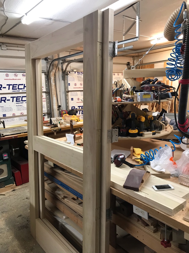

The bifold door thing is an issue I have been wrestling with Dennis. The weight factor for on the hinges for both doors will be an issue. At this point I am planning on using four heavy duty ball bearing hinges on each door. The jambs I made are 1 1/2” thick laminated poplar and the plan is to use long screws (5”) to go all the way into the framing structure on the outboard hinges. If that doesn’t work I will have to revert to heavy duty continuous piano hinges which are very expensive. For six it will be several thousand dollars.

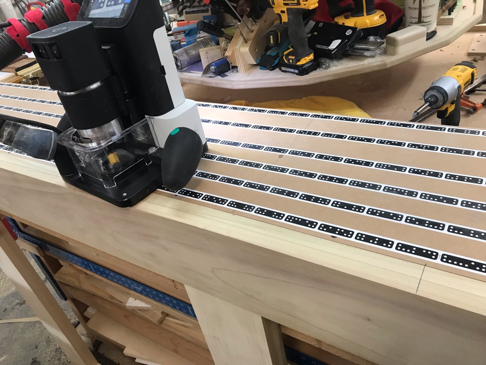

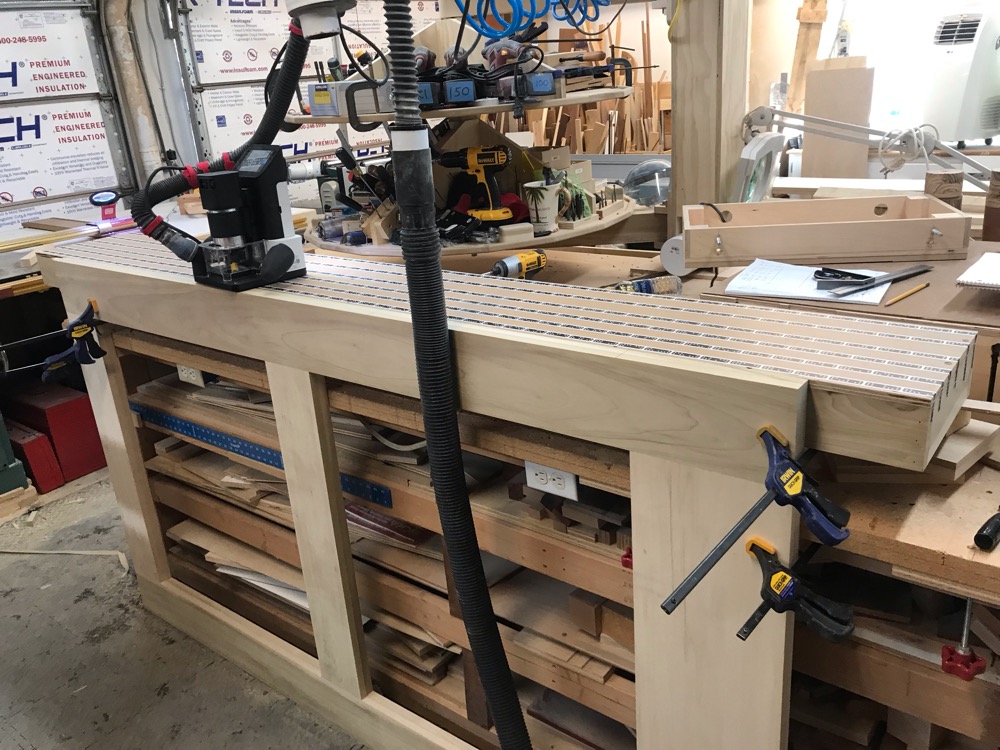

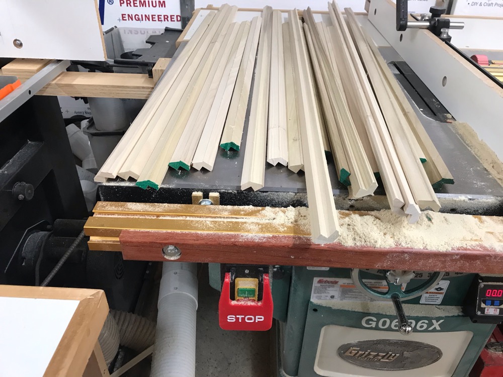

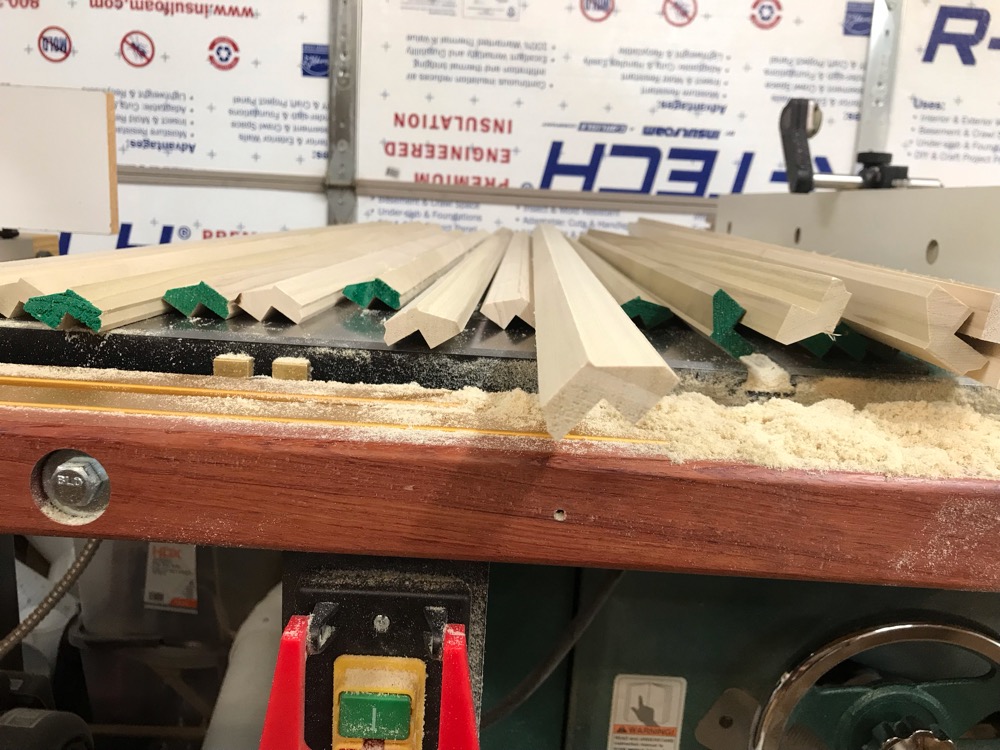

Long day today. Got two of the doors and the jamb for the smaller door finished and the moulding made for the panels. I decided to finish off the smaller door completely before starting the larger second one. I used the Shaper Origin to mortise the hinges. It was my first time using it to mortise hinges and it worked very well but had quite a learning curve.
