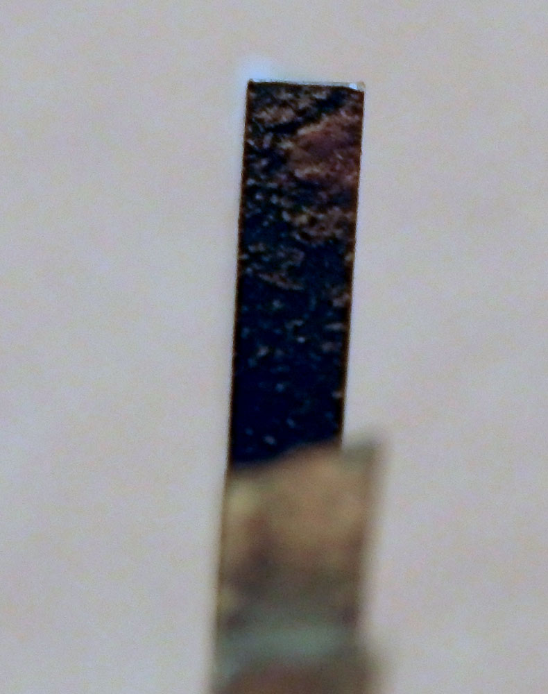

From the wording you quoted, I think you are referring to the dado blades sold by Shopsmith.
For my set of 6" dado blades (#505548), there is a "set" to the cross-cutting teeth. Simply place the two blades together so that the set of the cross-cutting teeth are facing the same way.
While the tops of the cross-cutting teeth are beveled, the raker teeth are flat, so the bottom of the cut will be flat.

- Two outer blades for Shopsmith Dado Set #505548
- P7260382-resized.jpg (245.46 KiB) Viewed 19780 times
- Close up showing "set" of teeth pointing up
- P7260383-resized.jpg (175.93 KiB) Viewed 19780 times
- Close up showing "set" of teeth (on left side of picture) pointing down
- P7260384-resized.jpg (181.63 KiB) Viewed 19780 times
- Beveled top of cross-cut teeth and flat top of raker tooth (in background, out of focus)
- P7260385-resized.jpg (154.41 KiB) Viewed 19780 times
- Flat top of raker tooth and beveled top of cross-cut tooth (in foreground and out of focus)
- P7260386-resized.jpg (107.46 KiB) Viewed 19780 times
- Two outer blades stacked with set of cross-cut teeth pointing in same direction (For this group of teeth, pointing down. Next group will be pointing up.)
- P7260389-resized.jpg (197.89 KiB) Viewed 19780 times
- P7260390-resized.jpg (376.56 KiB) Viewed 19780 times
- P7260391--2-resized.jpg (216.14 KiB) Viewed 19780 times

Yes, your diagram II.
Besides the angle of the top of the teeth pointing in same direction, the easiest way to tell (at least for me) is the set, or the slight leaning of the teeth in one direction or the other. Put the two blades together so that the "set" is the same for each group of cross-cut teeth. When correct, the two blades will fit tightly together all of the way around.
I added some descriptions to pictures in previous post to help explain what I mean better.
