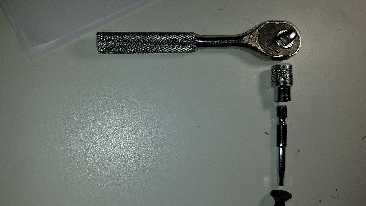

- Posts: 4544
Re: Aligning 510 main table
JPG asked
You said
Good Luck
This reminds me of what I use for stubborn set screws when disassembling Shopsmiths for restoration. On some of the Model 10's which are now around 70 years old and have set screws that may have not been moved in all those years and they can be stubborn. I use an Allen wrench socket and socket wrench for better torque. I have yet to find one I could not get out with the Allen wrench socket & wrench.What are you using to apply the torque to the wrench?
You said
I have tried that technique also without success. I ended up with a spiral twisted Allen wrench. That is when I tried the Allen wrench socket.using the opening at the end of an adjustable wrench (mentioned in the Shopsmith 510 on line manual) to turn the allen wrench.
Good Luck

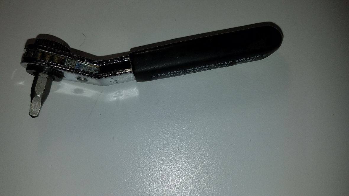

My suggestion (which I have employed) is much the same as JPGs.
Downward pressure while applying the twisting pressure is essential to keep the blade engaged with the screw head.
I knew I had a better solution; I just could not find it. Thanks to this thread I have now done some organizing in my tool cabinet. I'm real bad at putting things away when done using them.

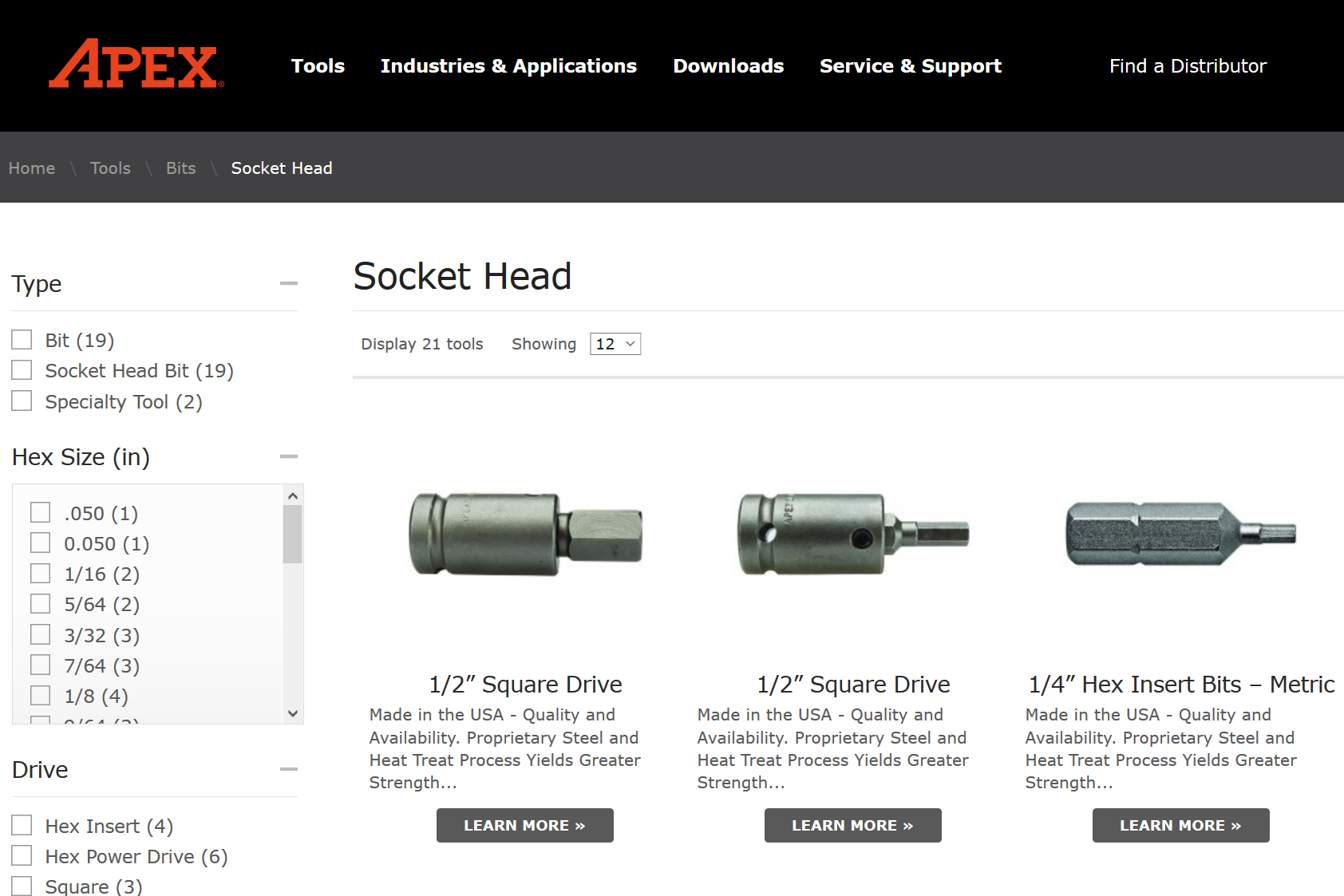

They are especially helpful in the smaller hex sizes. A common allen wrench has too much give and doesn't apply enough torque on tight screws. I tried to remove the blade wedge screws on a Pro Planer to sharpen the blades. A stock L shaped allen wrench did not budge them. I got out my Apex holder and a hex bit and they came right out.chapmanruss wrote:JPG askedThis reminds me of what I use for stubborn set screws when disassembling Shopsmiths for restoration. On some of the Model 10's which are now around 70 years old and have set screws that may have not been moved in all those years and they can be stubborn. I use an Allen wrench socket and socket wrench for better torque. I have yet to find one I could not get out with the Allen wrench socket & wrench.What are you using to apply the torque to the wrench?
You saidI have tried that technique also without success. I ended up with a spiral twisted Allen wrench. That is when I tried the Allen wrench socket.using the opening at the end of an adjustable wrench (mentioned in the Shopsmith 510 on line manual) to turn the allen wrench.
Good Luck
https://products.apex-tools.com/tools/bits/socket-head
