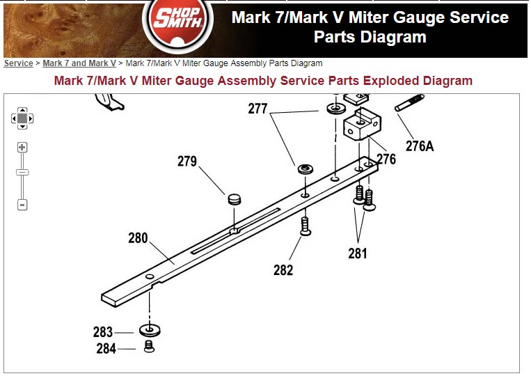

Okay ? My miter gauge on the table is real hard to slide in the slot. I have made sure the slots are cleaned and even used the Johnson paste wax. It then slides smoothly a couple passes then starts to act like above. Wondering what would cause the almost binding and making it har to slide. Any thoughts or if another thread to help me

Is the set screw (#279 in attached Parts Diagram) that can be used to expand the bar and lock the miter gauge in the miter slot perhaps partially tightened? Or is the miter gauge bar perhaps bent?
There are also nylon glides on the underside of the miter gauge body that may need replacing or just "adjusted" so that they function better. Here is a thread that discusses the two different types of glides: https://www.shopsmith.com/ss_forum/view ... ge#p254515

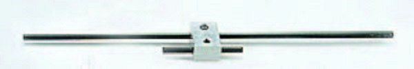

With the information above, loosen the expansion set screw in the middle of the bar or remove it completely. Set the glides so they just barely lift the Miter's protractor off the table surface. Your Miter should slide easily in the slots. It is unlikely your Miter bar is bent but if it is you will have to replace it. It is part number 518104 Miter Gauge Bar. Remember when adjusting the older style glides, as shown in the link of my earlier post, they adjust from the top and it is the same hole that the set screw goes into for attaching a Miter Gauge Stop Rod (as shown in the picture below) to the miter. If present, the set screw needs to be removed to adjust the glide.
