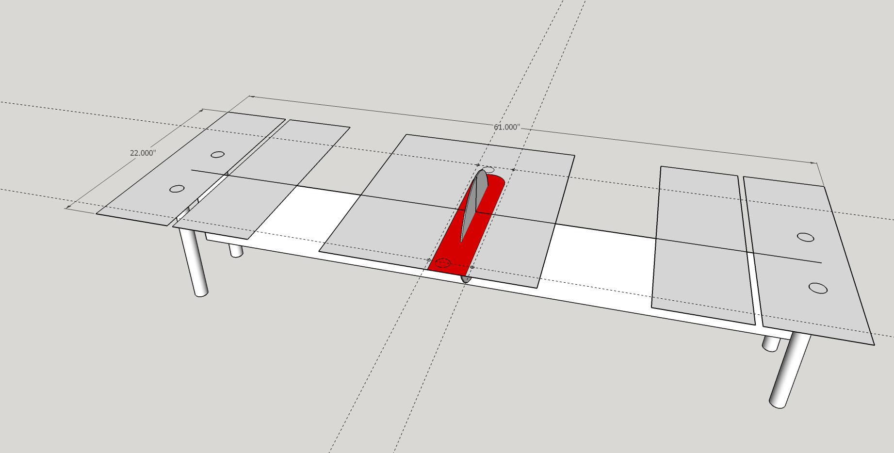

Spooner wrote:Does and anyone know or has anyone seen clipart or images of a shopsmith from the top looking down? Or even dimensions of the 520 table system and its orientation across the saw would be good. I could build that up in cad. I'm putting together a shop layout drawing and I want a symbol for a shopsmith. Anyone have any thoughts or ideas?
I don't know exactly what you need. Does this come anywhere near what you are looking for.
Main Table and Two Floating Tables with Dial Indicator.png (87.73 KiB) Viewed 28997 times

I'm not sure what you're looking for. Sketchup's "3d Warehouse" has a Mark V Model 500 (complete with belt sander) in a 3D image that can be rotated any way you like. But it's not a photograph - it's an artist's rendition of one.

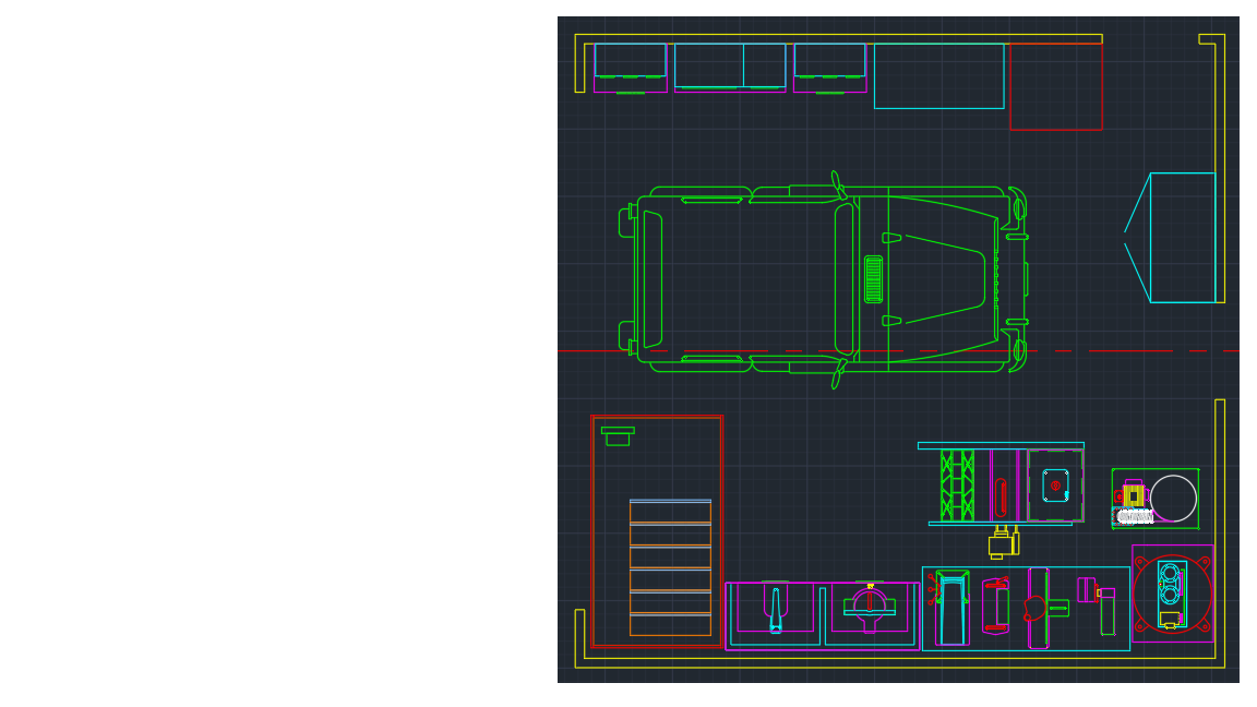

That's real close Dusty but I need the full (what is it?) 6' length of top? I'm looking for a Top View of the saw. This is my shop layout I'm working on. With my current tools. But I want to see where I could place all the SS tools and see how much space I can save.
My Shop Layout 1.png (118.82 KiB) Viewed 28917 times

I'll take anything ya got Dusty. Thanks for sharing. If anyone wants a DXF of the drawings I'm using just speak up. I'd love to share.
I have a 25' x 30' concrete driveway I can use for the big stuff. Just roll the SS out there and start cutting. Plus I pull the jeep out and that opens things up too.

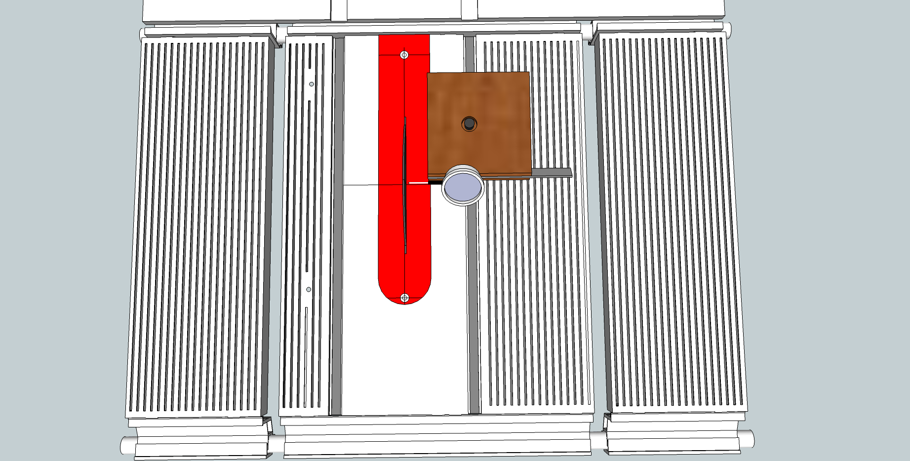

Here's kind of what I was looking for.

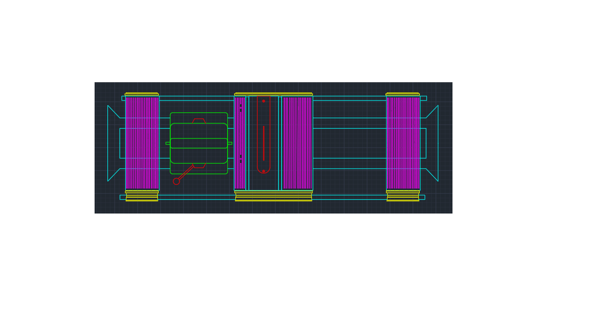

Here's what I came up with. Any thoughts? Does that look close?
SS Mark 7.png (68.01 KiB) Viewed 28744 times

Spooner wrote:Here's what I came up with. Any thoughts? Does that look close?
It appears to be proportionally correct. I measure the overall length to be 61" with the two end tables mounted. The main table measures 17"x22".
Shopsmith Layout with Cntr Line, Spooner 1.png (60.15 KiB) Viewed 28732 times
And these dimensions are coming from a 510 or 520? I assume the 17"X22" is without the fence rails?
