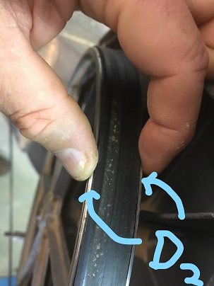

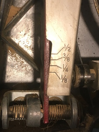

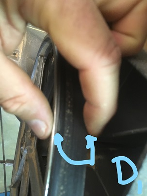

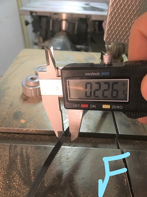

I now have photos and with luck, I can insert them here.
There are several suggestions that seem right on so far. First, since the bandsaw was stored unused for quite a while, I suspect you are right that it was stored under tension. Here is a picture of the current tension setting (E) , as well as a measurement of the blade that was on it (F)
When I checked both belts, there was no sign of any "adhesive", and I was able to nudge the belt from side to side. After my first test run of the bandsaw, I smelled faint hot rubber, so I shut the machine off and opened it up. Everything looked right, but I noticed that both belts were working their way up the back side of the groove in the wheel. Note in photo D1, you can only see one side of the wheel because the belt is covering the right side. Then in D2, you can see both side of the wheel because I pushed the belt back down in the groove slightly: Lastly, though the belt that came off the upper wheel appears to be in good shape, the belt on the lower wheel has a number of cracks and small tears on it. (See G)
Would love to hear your analysis.
Replace both belts? Ensuring use of adhesive....
How to know when a blade needs to be replaced?
Anything else I need to check?
Thanks!
David
