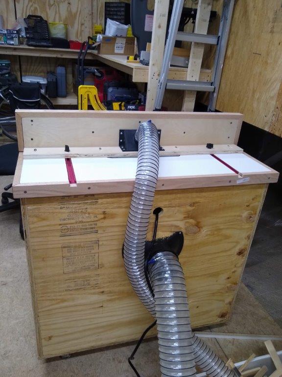

JPG- yeah- i think it will need some holes somewhere otherwise every crack and crevice will be whistling under vaccuum. Her choice of the back likely was an aesthetic choice rather than an air movement choice.

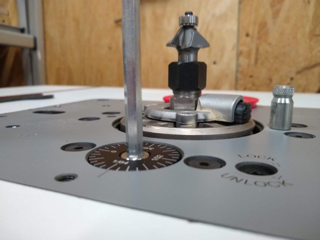

Garys-actually-the lift is able to bring the bit up high enough you can access everything from the top side. I like your table design- portable to the outside which means dealing with dust collection goes away. I hate dust collection !

A couple things that made my RT a bit more friendly were 1.An on/off type foot pedal switch and, 2. A dedicated cheap cordless drill with a hex rod insert to operate the Jessem lift.

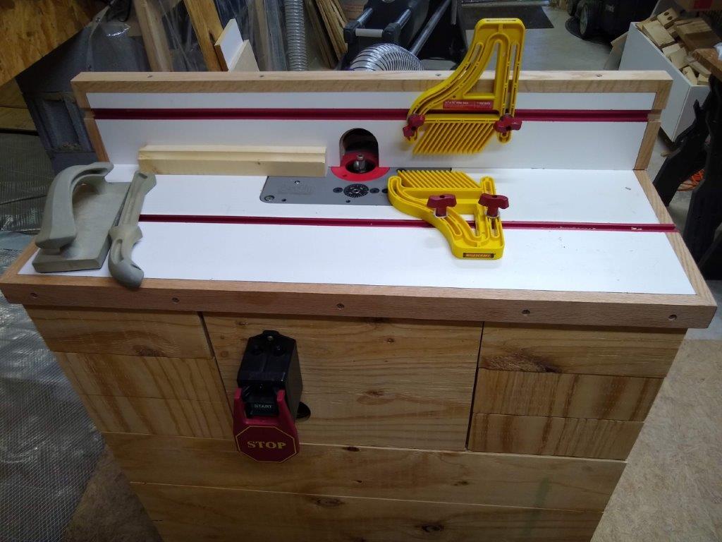

Alright-its near complete now.
Hopefully now I can use it to come up with some sort of manly handles/knobs for the drawers.
Not happy with the stickiness of the Milescraft featherboards. They tend to stick in the t-slots and not slide easily when loosened and the bolt tilts.
I added an extra hardwood edge to the fence which goes along with the table surface theme..as I had enough of the material still around.
It seems to catch pretty much all the dust generated-though I haven't run it long term to look for build up.

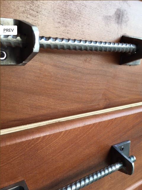

You can’t make them with a router table, but these are the manliest drawer pulls I’ve ever seen. :cool:
rebar drawer pulls.jpg (61.6 KiB) Viewed 20875 times

rebar- a manly good idea !
