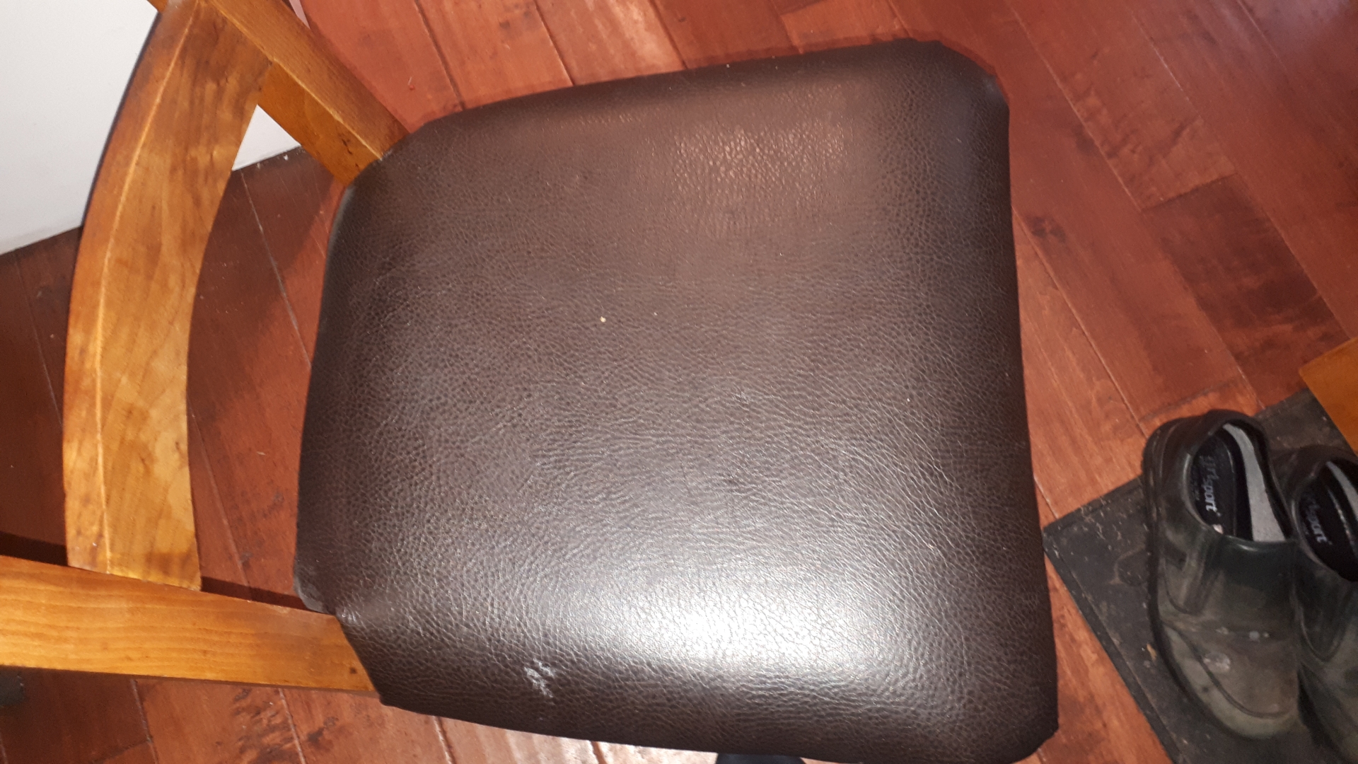

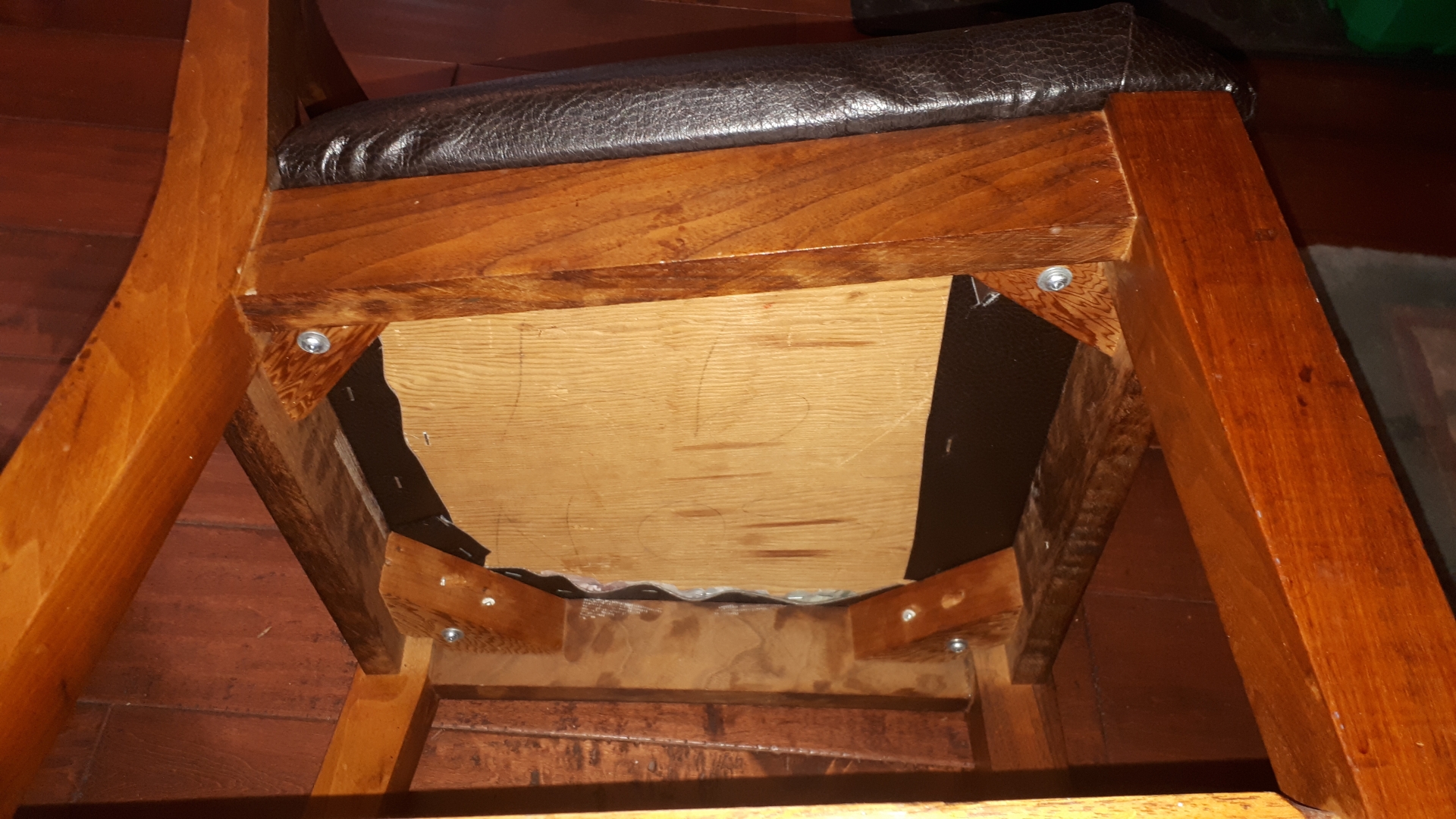

My thought would be to cut a piece of plywood to fit on top of the frame with 1/4 round cut outs where the legs come through, and upholster that, then screw on from the bottom. The plywood doesn't need to be very thick as it is supported on all sides.
This is a chair I made in high school that is done that way,
chair top.jpg (1.34 MiB) Viewed 11785 times
chair bottom.jpg (1.29 MiB) Viewed 11785 times
