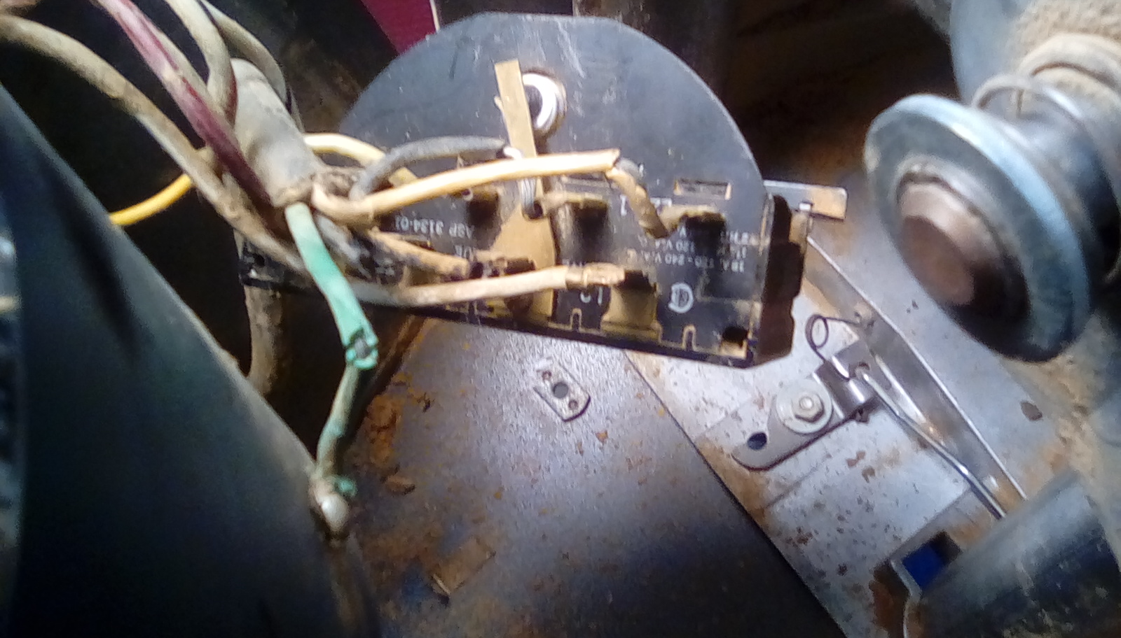

OK. A pix of the wiring and switch might help. I suspect incorrect connections.
We may need to measure motor wire continuity which will require removal of all wires from the switch.

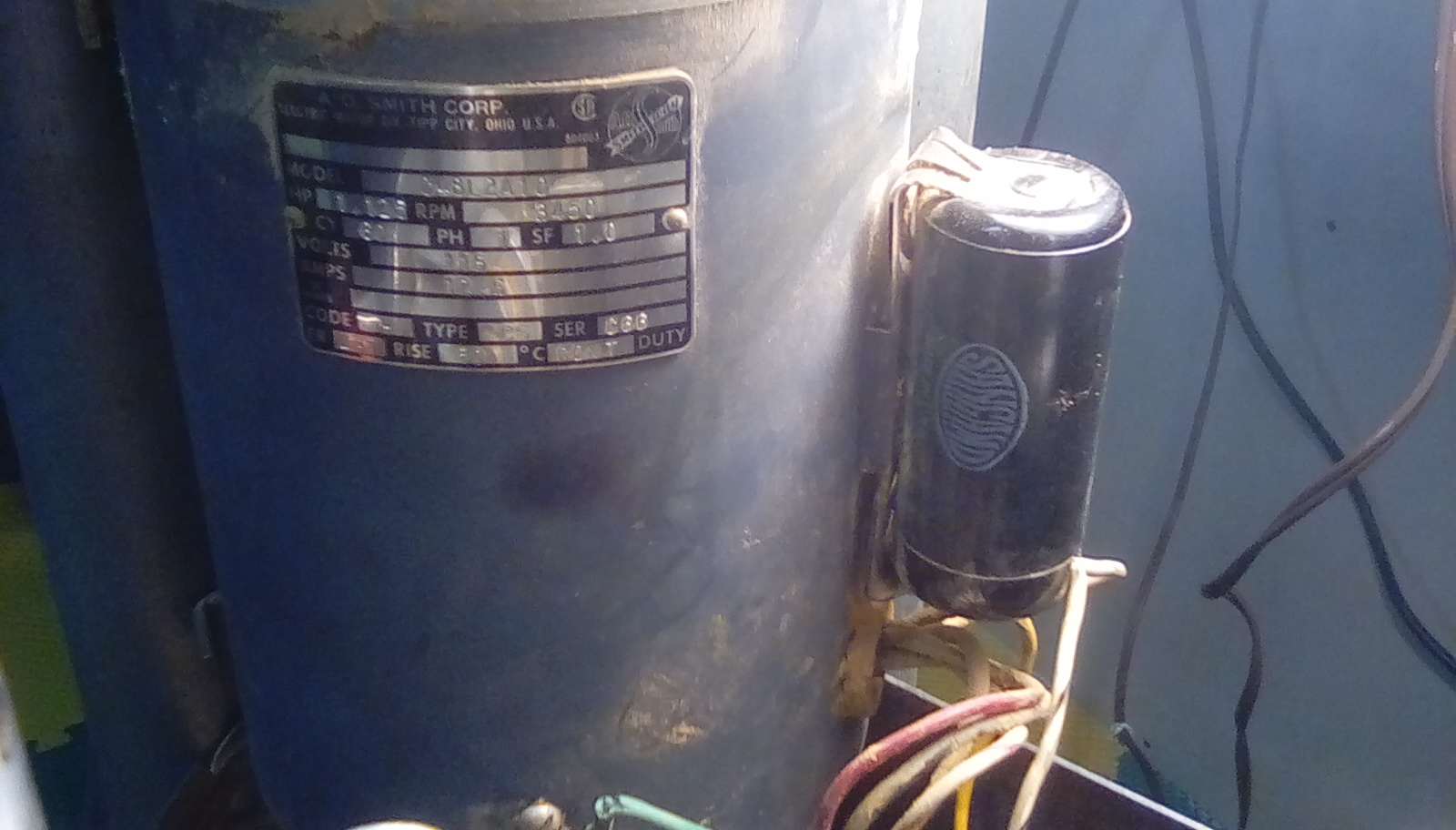

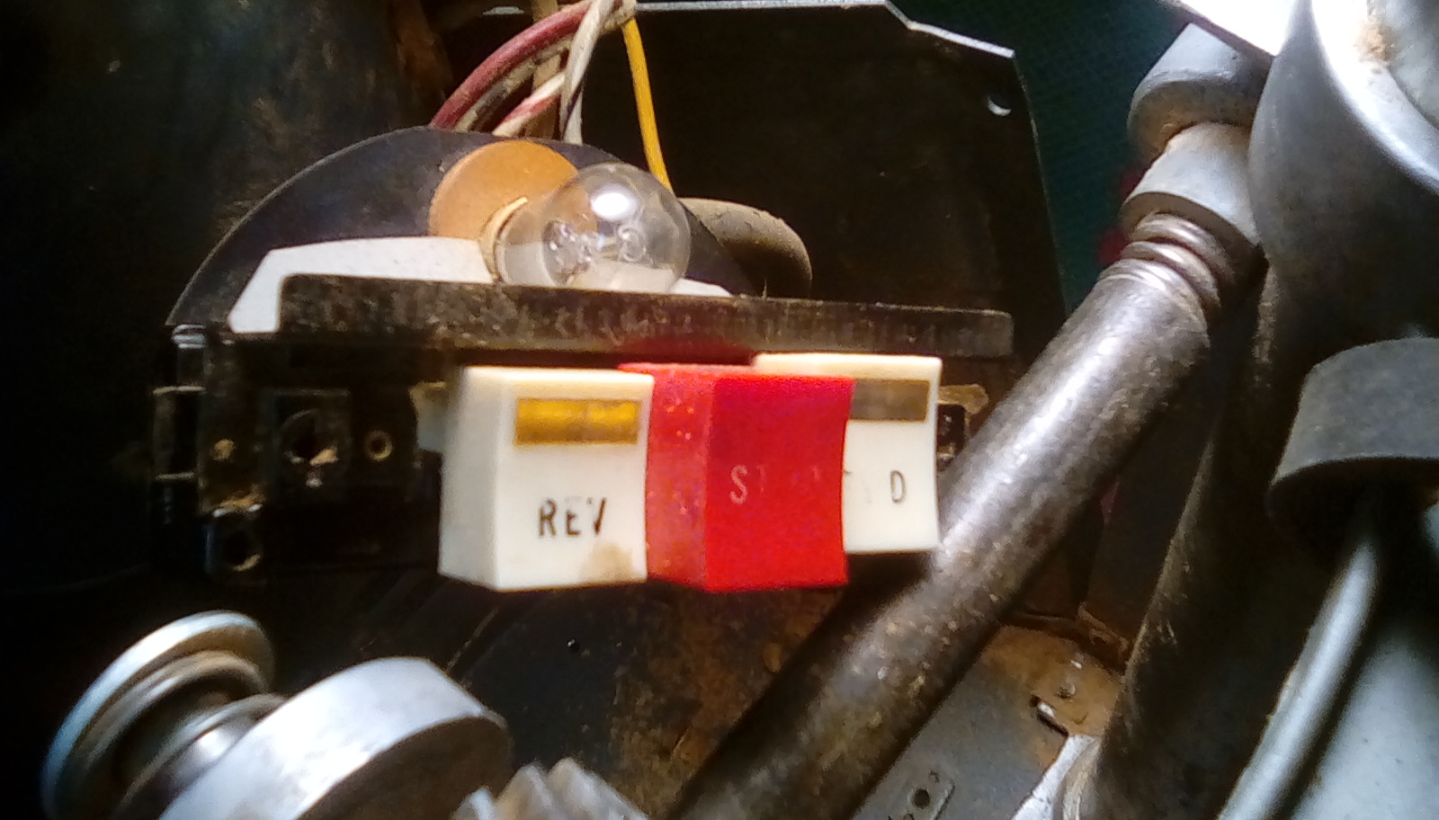

Here are the pix. I will try to find the relay and get back to you.

I have done some more research and find that the version I have does not have a starter relay. I have a "motor start capacitor" and an "Internal Centrifugal Motor Start Switch". Could the capacitor be dead? That looks like it would be an easy fix (HAHA).

It is an easy fix. Statistics might tell you that it is not the capacitor. Be careful of the two leads. When you first get the two wires disconnected- short them together like with a screw driver). From there, it is as simple as it looks.
Clean (like burnish) the relay contacts if the capacitor does not fix it.
