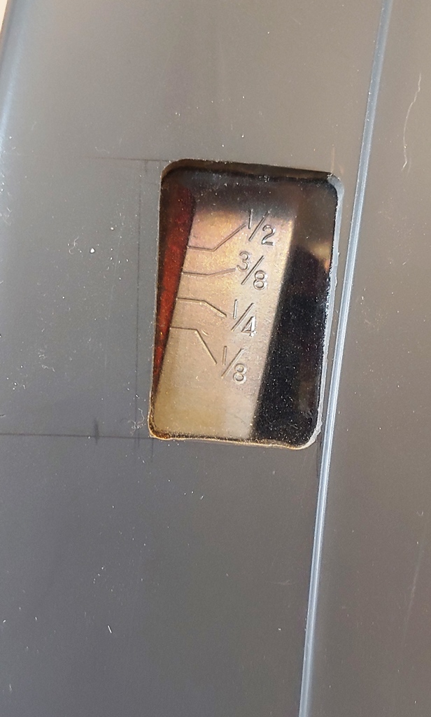

Re: Need help on how get started!!!!
The new cover is absolutely worth it. You can adjust the blade tension without removing the cover. You should release the tension on the blade when you get done for the day so it should always need to be re-tensioned.Vetwoodrestore wrote:The blue aftermarket ones not the red ones ss sells?
Mine in from 1981 so I assume I will do that upgrade then as well, do you think the new cover is worth it with access an clear panel?
However, you don't need to buy the new cover. I modified mine. Drill a hole for the tension screw and cut an opening for the tension scale. I super glued a piece of plexiglass to the inside of the cover. It has been there for over 10 years.
- 20191114_161256.jpg (215.31 KiB) Viewed 13154 times
