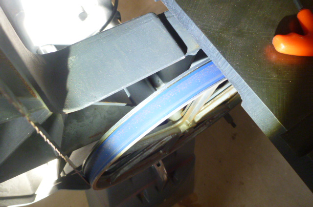

On the 1980 it was rode hard and put away wet by the time it arrived to me. The tyres were torn and sections were missing. I scraped off the old tyres as best I could then used zip-strip to get the wheels perfectly clean. Next I installed blue bandtiresawwearhouse tyres. They came with excellent instructions and a tool to aid in the install. Nothing to it, no glue, just soak in hot tap water and stretch on like an old fashion sew-up tyre. I've been using a 1/2" resaw blade exclusively and no issues at all.

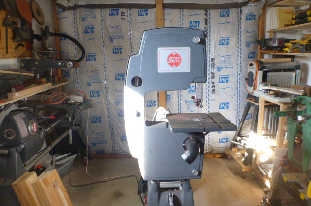

The old girl all spiffed up!

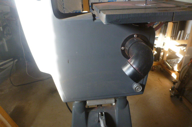

Dust port
Dust port

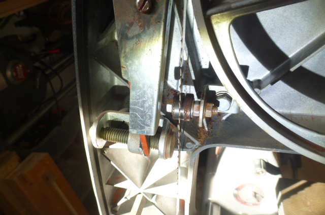

Double RS627 bearing on 7mm x 1mm x 40mm.  Blade is loose and therefore not centered between the double bearing's slot.

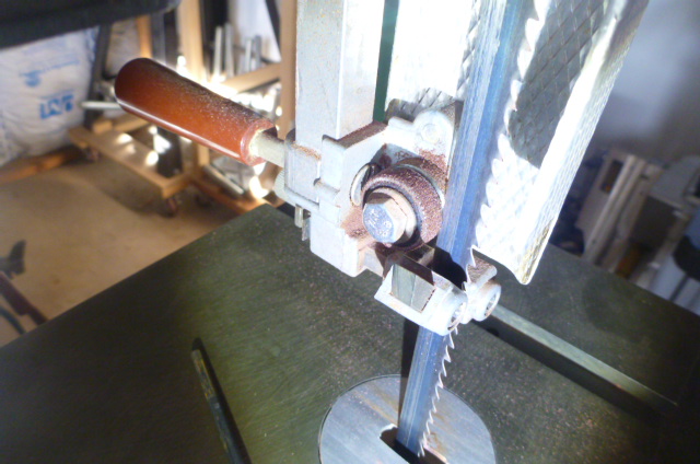

upper guide with double RS627 bearing on 7mm x 1mm x 35mm bolts.

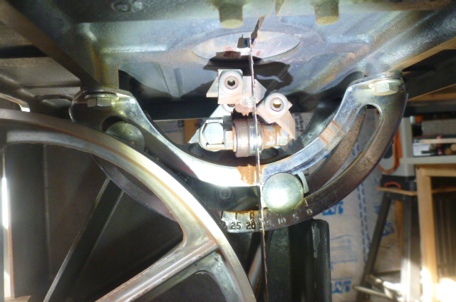

Lower guide with double RS627 bearing on 7mm x 1mm x 35mm bolt.  Blade is loose and therefore not centered between the double bearing's slot.

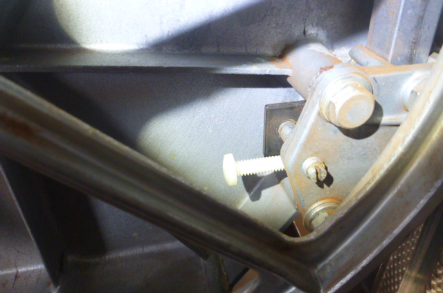

Nylon 1/4" x 20 bolt on upper guide
Blue tyres from bandsawtirewearhouse
