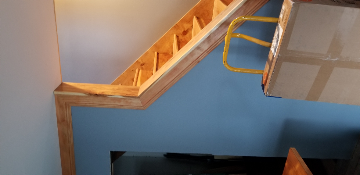

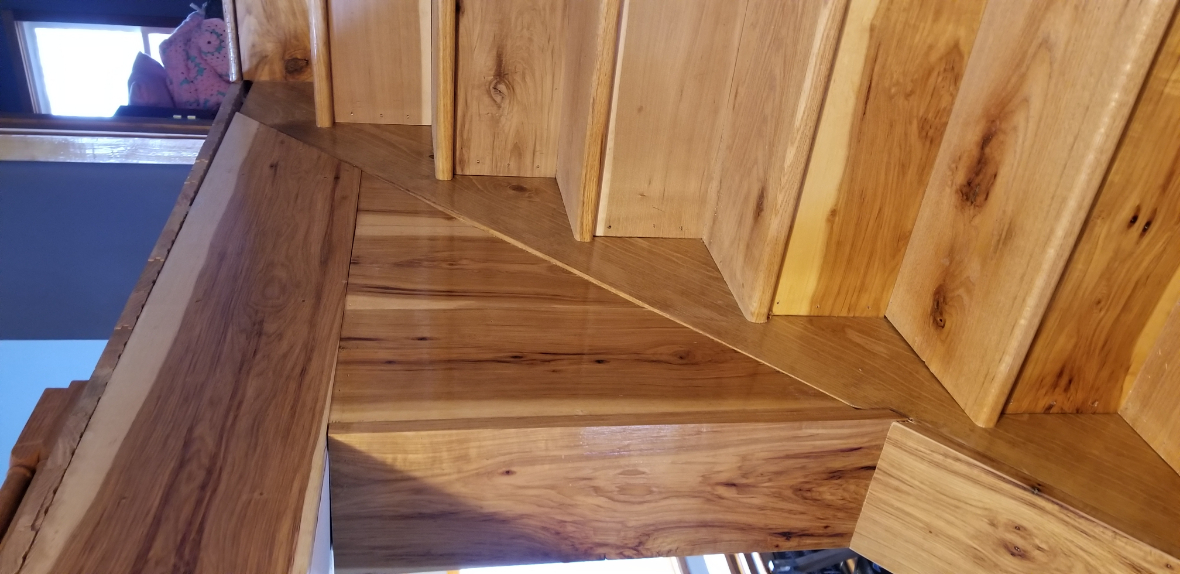

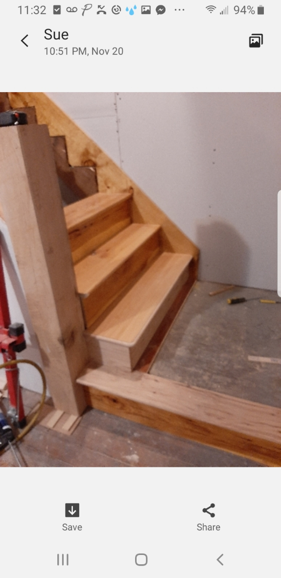

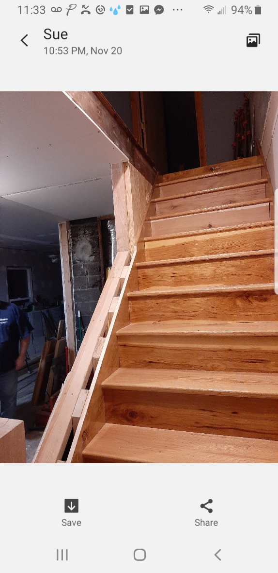

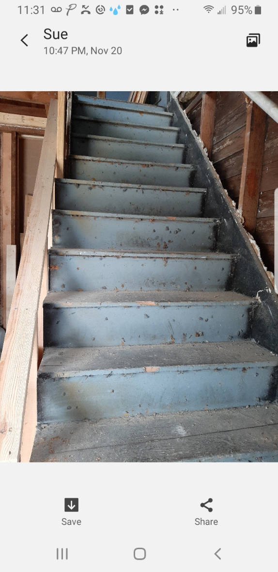

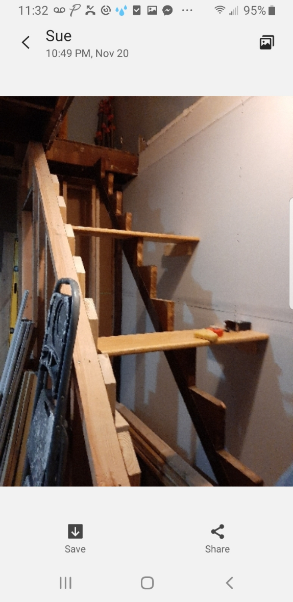

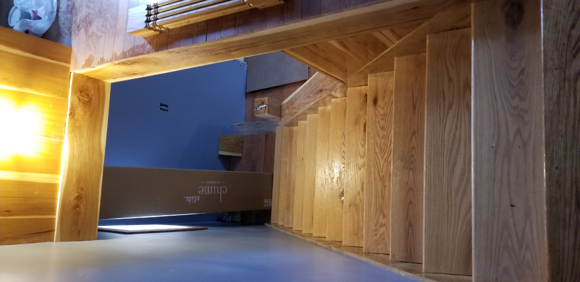

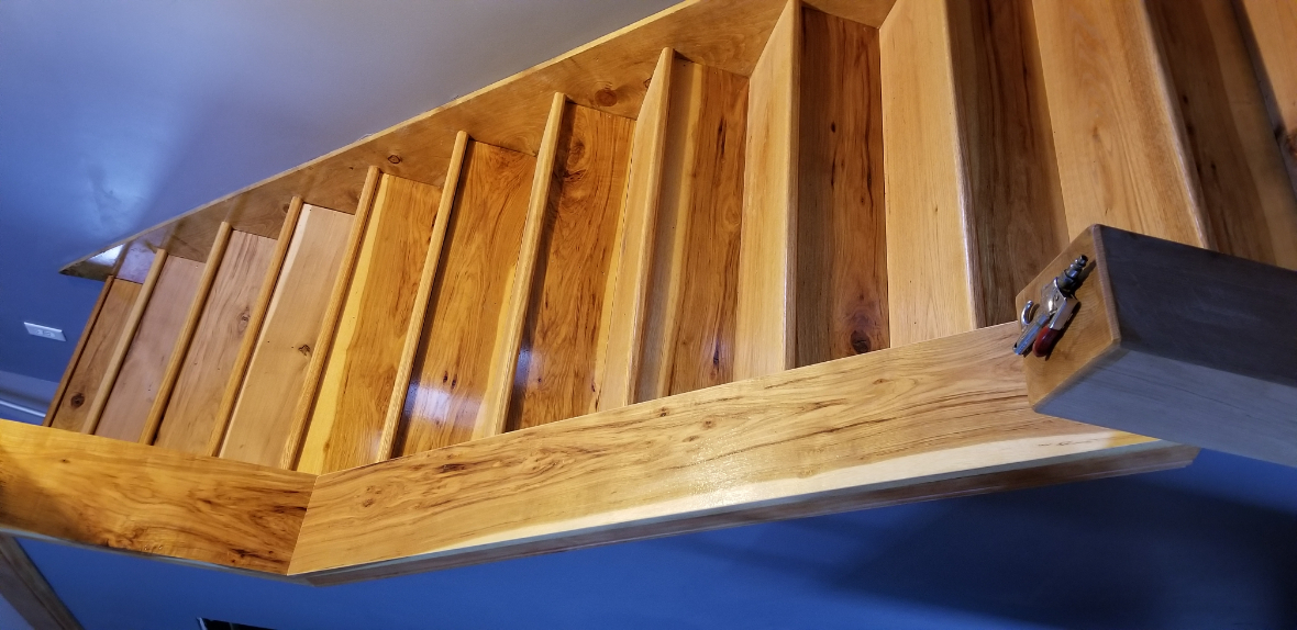

from bottom up the old stairs were removed, the old stringers were removed and used as a pattern ,then insulation and new dry wall was installed , a new stringer was added to the side of one of the old ones , the treads you see temporarily attached to the wall was because access to the up stairs was needed for a few tools , the stringers were reinstalled and one replaced , those are oak treads and hickory risers , #2 pine was used for the sides , a hickory cap and trim will be added after the drywall work is completed .
The oak treads and hickory risers are all rough cut and air dried 16 months in a attic , then planed sanded and ready for the finish , out of 16 stairs only 3 spit out and were not usable that's not too bad in my book , they will be cut and used for a shelf in a closet some where , they were all ripped down and the ends were sanded on the SS mkv, after cost was figured we have a little over 3 dollars a board in the oak treads and less for the risers . when compared to the oak treads at the big box it was hands down a huge savings and well worth the time in the attic ,the SS and planning ahead has saved us a bundle .the ss paid for its self on this job alone !! oh the newel post is 6x6 oak and still needs work lol

Beautiful job, and kudos on thinking ahead. Is there a reason for the hickory vs. oak on the risers, or was that just what you happened to have on hand? Actually, looking again at the pictures, the hickory is rather dramatic. Was that your plan?

Thanks, I believe the ladies have done a great job considering what hey had to work with, and, being their first time building stairs , the wife did a supper job on the risers ,but then she had a awesome coach lol ,, patting myself on the back !! this is all ,their, work and they made me proud , as to the finish I like the idea of a carpet runner but experience has taught me they can be a trip hazard as well , so still not sure what they will do . I want them to add some decorative walnut bling along the sides of the risers but not sure if they are on board yet. I tell them the bling is what makes the job , they seem to like the plain look, as far as the hickory risers it was planned ,we were gong to make hickory treads but the oak was what we had , I was surprised how well they contrast together ,also was odd we had just enough oak for the job , the hickory grain stands out even more in real life then in the pictures .it is very color full .
