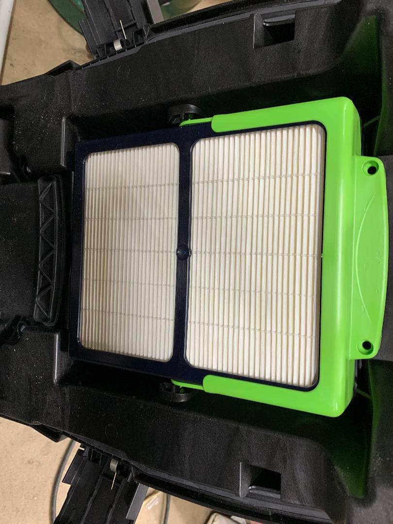

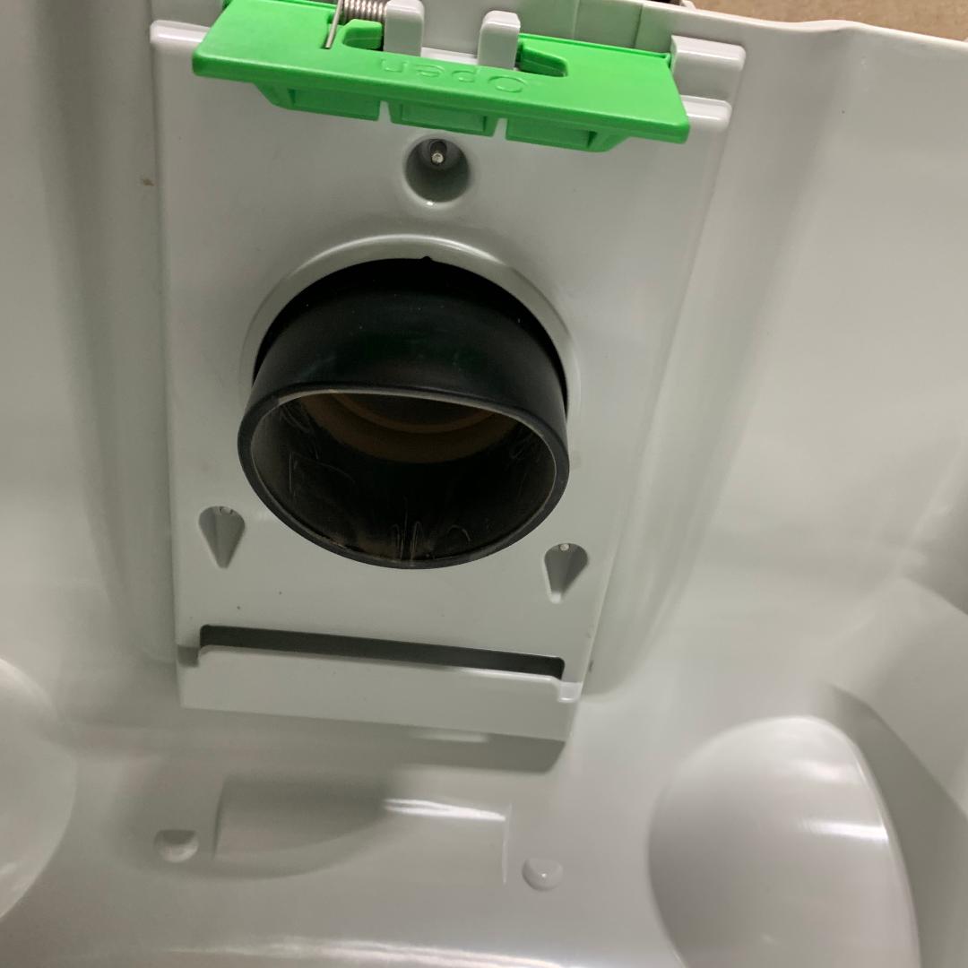

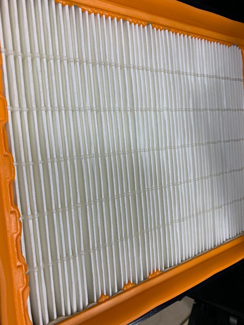

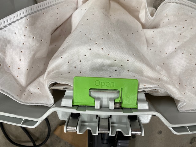

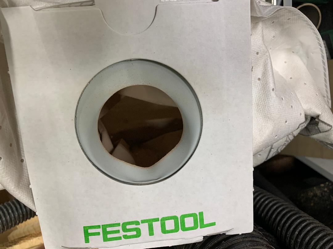

I have the Oneida Air System sitting on top of my CT26 so right away things would be different. I did take it apart today and shot a few pictures which I will post here. I wanted to check the level of dust in the bag since I know very little actually goes in there with the cyclone box for sure getting all the large particles. As expect there is almost nothing collecting in the bag.
This is what the inlet of the bag looks like:
ft 1.jpg (82.16 KiB) Viewed 17470 times
The inside of the machine where the bag attaches, looks really clean I think:
ft 2.jpg (56.74 KiB) Viewed 17470 times
You can see discoloration on the top of the bag where the air flows into the filter:
ft 3.jpg (151.46 KiB) Viewed 17470 times
Likewise the filter is showing some discoloration, but that is how it should be:
ft 4.jpg (124.08 KiB) Viewed 17470 times
The other side of the filter:
ft 5.jpg (114.18 KiB) Viewed 17470 times
I also checked the gasket all the way round and there was no indication of dust on the seal so I'm pretty sure my unit is sealed up pretty well.
So while doing this it occurred to me that the area above the filter should be really clean looking and you shouldn't see any dust in that area. If there were a leak in the system then there should be dust in that area, that is after all the only place a leak can provide dust to the shop. So really look that area over for dust.
