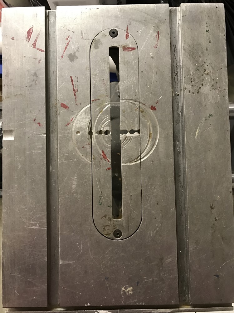

I can agree with your definitions for Rebuilt, Refurbished or Restored. I use the term Restored in the ads when selling the Model 10's and some of the Mark 5's I have restored because as per the definition you give that is what has been done to them. When resold they have all the parts included that they came with from the factory. Sometimes a challenge to get all of them for the Model 10's. There have been a couple of times they were like items. On one I used a current Drill Chuck instead of the Model 10 version of the Jacobs 3326 comes to mind. There was also a Model 10E with the metal extension upgrade instead of the wood one that a previous owner had changed. I guess I should have listed that one as Restored and Upgraded.
I Refurbished a 1983 Mark V which is how I listed it when I sold it. All the painted surfaces were touched up as needed and parts replaced as needed to have a tool as it originally came from the factory with all parts it originally came with. One of the parts replaced was the main table and insert. The picture below shows why.
The insert is ready to break in half.
