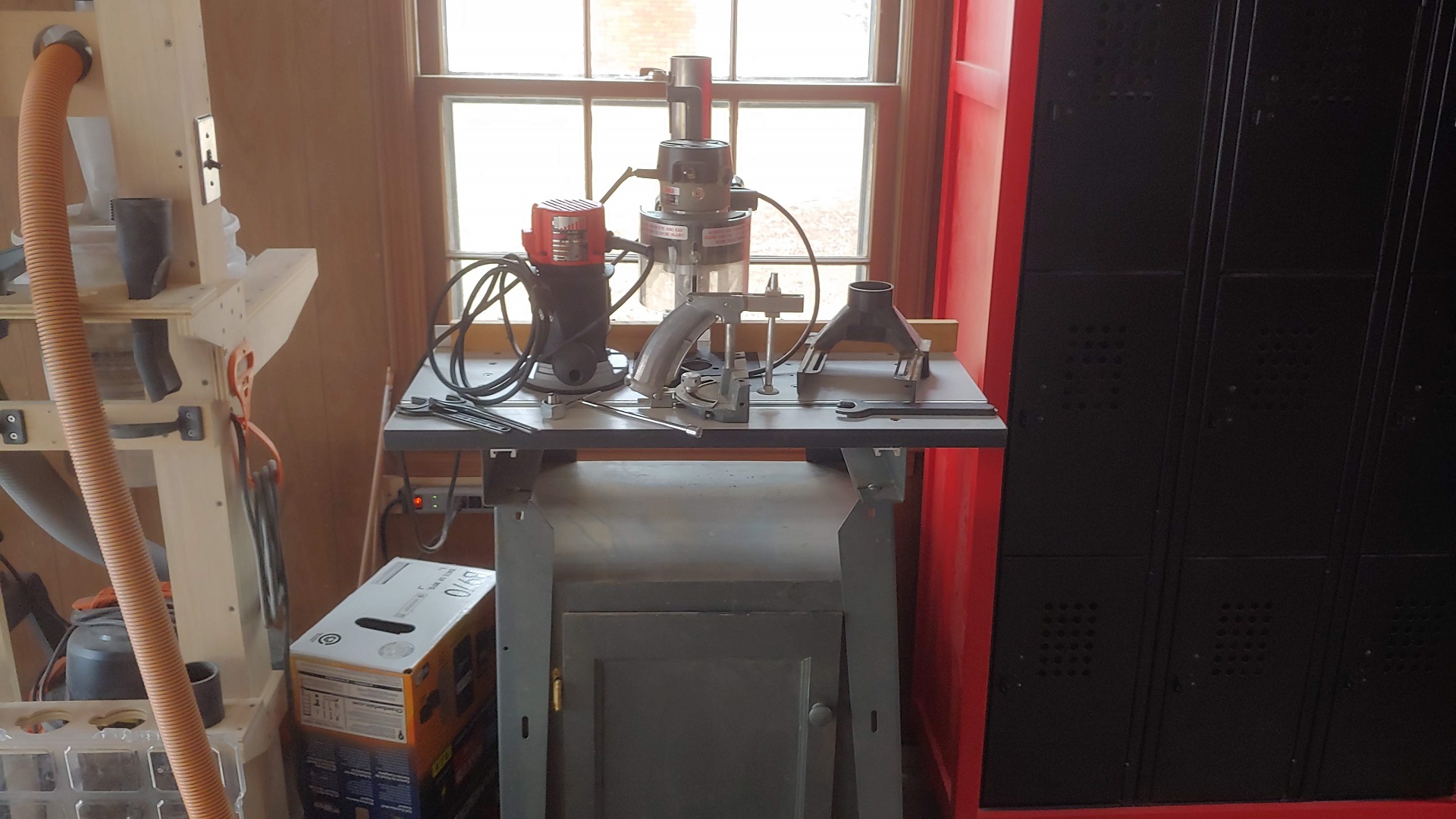

I recently purchases a couple Shop Smith tools. The first being a 1989 over arm pin router that came complete near as I can tell. I will be placing the upper assembly on to a custom cabinet so the stand will be available in the near future if anyone is interested.
The second is a one owner Model 10ER built in 1952 I'm told. Below is a pic of everything that came with the purchase. The whole thing was picked up for $200 bucks including the full set of 1950s craftsman lathe chisels.
So far everything on this 10ER is working great. It definitely needs a new belt. I found one on MKC Tools but if there are better places to get one let me know. The only troubling issue I have is some rattling sound coming from the head stock pulley. I took the cover off to eliminate that as a cause and its definitely right at the head stock pulley. From the videos i've watched and reading ive done there are 2 bearings in the head stock but neither is at the pulley so I'm not sure what to do next.
