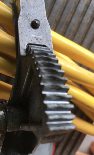

I think I found the problem. I removed the speed changer and cleaned it up. Once I saw what the teeth looked like, I figured that was probably it. The speed changer works smoothly to a point and then it hangs up, even outside the headstock with no load on it. I was going to order just a new quadrant since everything else looks okay. However, every time I order parts piecemeal, I end up needing something that I hadn't ordered. So, I ordered the whole assembly. Hopefully it won't take 6 weeks to get here like it did when I ordered the control sheaves.

Since you have the speed control 'in hand', some judicious filing of those mangled teeth cam bring it back to operable. By sighting from the side so light shines between the worm gear and the pork chop gear, you can determine where to file away all interferences(one at a time).
Beats waiting 6 weeks (or more).
The porkchop pivot looks tight(A common source of this gear wear is the arms the pivot pin attaches to become spread adding side play of the porkchop to the mix).

JPG wrote:Since you have the speed control 'in hand', some judicious filing of those mangled teeth cam bring it back to operable. By sighting from the side so light shines between the worm gear and the pork chop gear, you can determine where to file away all interferences(one at a time).
Might have to give that a try while I'm waiting (semi)patiently. Thanks.
