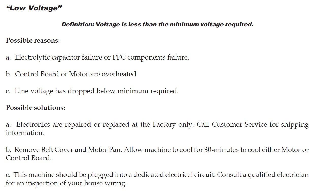

I don't know if this helps you, but this is from the Mark 7 Troubleshooting Manual. How hot is the headstock when this happens? Also, Russ' suggestion for checking line voltage is a good one.

Did you happen to see my post or the Mark 7 Troubleshooting document that I posted? Turning a 14" bowl, my guess is the headstock is getting overheated. How hot to the touch does the headstock feel when this happens?rdgrnstd wrote:Well I move to another power source. This time I'm using one leg of a dedicated 220 outlet with #10 wire. Still same issue. Still getting a "lowv" on the top line, to the right of the speed selected, when under a load.

I saw the Mark 7 Troubleshooting document you posted. Thanks for posting it.
I have overheated it before. But It doesn't seem to have to get hot for the low voltage to show up.
I'm still probably overheating, just noticing the error before I can really feel the heat.

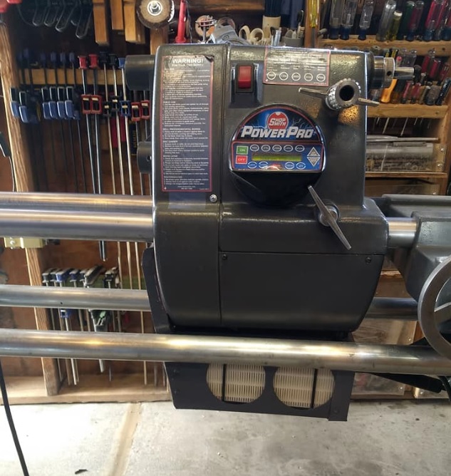

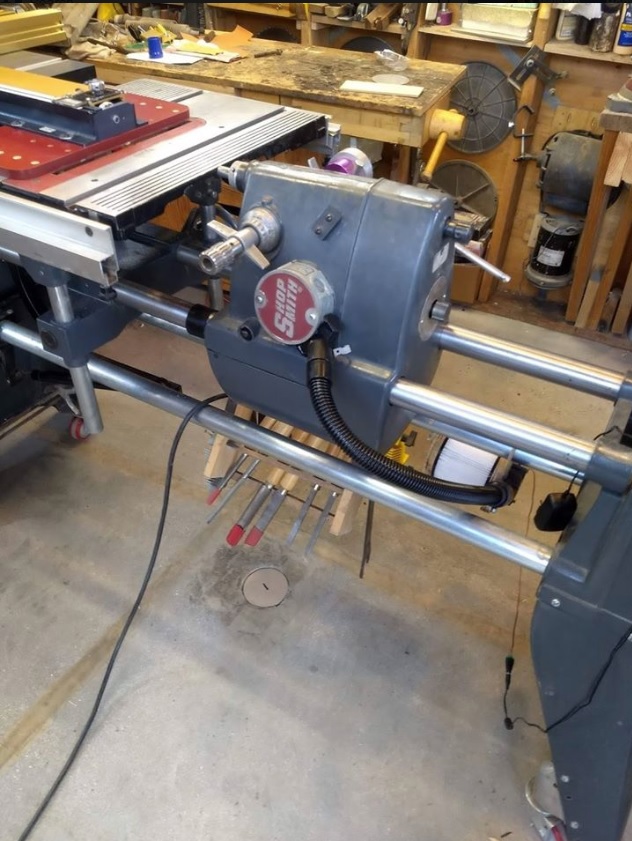

I don't know how comfortable you are with modifying your PowerPro, but I have heard of more owners doing this solution to solve the overheating issue. IF you have access to Facebook, you might want to check out these posts related to adding a fan and small HEPA filter to your PowerPro. Supposedly, if done properly it both cuts down on the overheating issues AND solves the dust inside issues that cause the motor stator position error. I believe the first solution is kind of a bolt on fan solution that connects to the access on the back of the PowerPro, so no modification to headstock. He has a new and improved solution (2nd link) but I don't know how it attaches to the PowerPro headstock, i.e. it may require further modifications. Sorry to post Facebook links here, but I really haven't seen much discussion of an overheating solution on this forum. If I missed a past thread from this forum, maybe someone else can post it here to help. For the noise, I don't know if this helps, but there was a recent discussion on PowerPro noise. Check out the Shopsmith forum link below for that thread regarding noise. I hope this helps:rdgrnstd wrote:I saw the Mark 7 Troubleshooting document you posted. Thanks for posting it.

Guess I'll have to join Facebook to see what someone else has done. I have no problem modifying it.
I've thought about an external fan but haven't got serious about it. I still need to open it up and check for the noise.

I am no expert on it (since I don't own a PowerPro) and this is just what I read online, but the idea with this kind of solution is it keeps the PowerPro cooler. I think I saw 10 degrees cooler posted somewhere. Supposedly, the clean air getting pumped in from this HEPA filter causes a positive air displacement inside the PowerPro headstock, i.e. always air going from inside to outside through any cracks and openings. By creating a positive air displacement, in theory, no dust would ever enter the PowerPro headstock, so it cuts down on the stator position sensor errors that creep up from dust infiltration into the headstock.rdgrnstd wrote:Guess I'll have to join Facebook to see what someone else has done. I have no problem modifying it.
