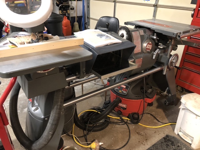

Completed my SPT set today, found locally a used jointer to add to the collection.
- Belt sander
- Strip sander
- Lathe Duplicator
- Scroll saw
- Band Saw
- Thickness Planer
- Edge Jointer
- Conical Disc Sander
- Biscuit Jointer
- Various router, shaper, and moulding bits
Add to that the original SS functionality for Table Saw, Boring/Drilling/Sanding/Polishing and Turning and I think we have a winner!
Time to make some saw dust!
Too bad I cannot run them all at once where they are currently mounted ;)

With all those tools, your shop floor should already be covered with 3 inches of sawdust. :)

You got two things I’m still waiting on, thickness planer and the strip sander.
I’ve got a feeling you’re going to have fun and enjoy them.
