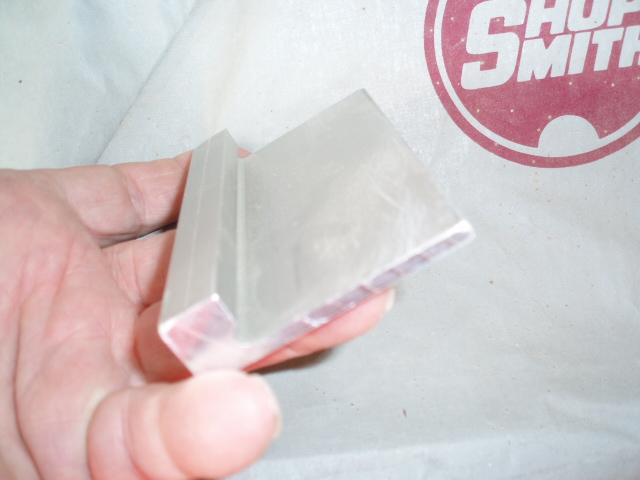

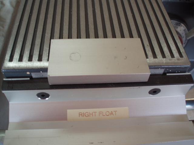

If this is what we are talking about, you should have at least one of these that came with your upgrade kit. It is used to adjust the height of the rails with respect to the table top. The one I received was about 6" long. I cut it in half to have two; one for each end of the rail.
I set the table upside down on a "flat" work surface with the gauge between the work surface and the table and secure it there. Then I put pressure on the rail to press it against the gauge and secure the bolts.

If this is not the gauge you reference then I have no idea.

Dusty, thanks SO much for the photos. Ends up, I already have that, it came in a little box of misc. stuff that the previous owner's daughter said she thought were SS parts, but wasn't sure. Now I know they are, and what they are.
