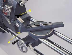

I think you need to measure the entire assembly, from the bottom of the UTR arm (A in the picture) to the top of the original Shopsmith Bar (B). The terminologyproblem is that the entire assembly is called the tool rest vs. the bar that actually holds the tool.
- NewLatheToolRest.jpg (11.88 KiB) Viewed 31620 times
or maybe to the center of the spindle, and then you can play with the 1/4" up or down from there. Gotta be able to get the top of the toolrest to be even with the center of the spindle and then above and below it.
Good pic. worth at LEAST a thousand words.
