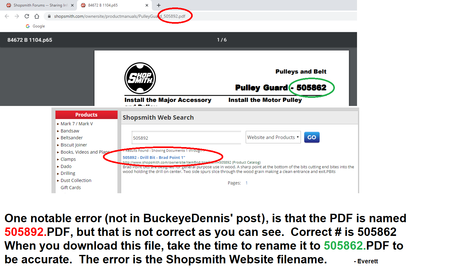

Note there is a file naming error on the Shopsmith filename as seen when opened....
Everett
Re: First Post - Hello and a bit of advise needed, Band Saw
Admin take note!!!
