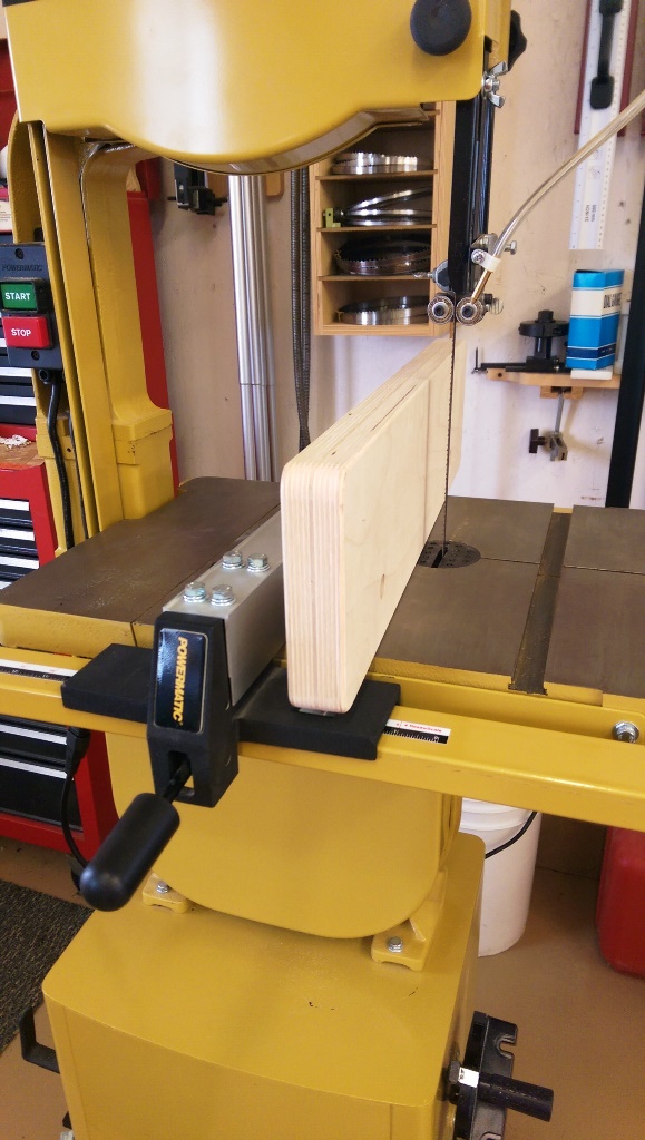

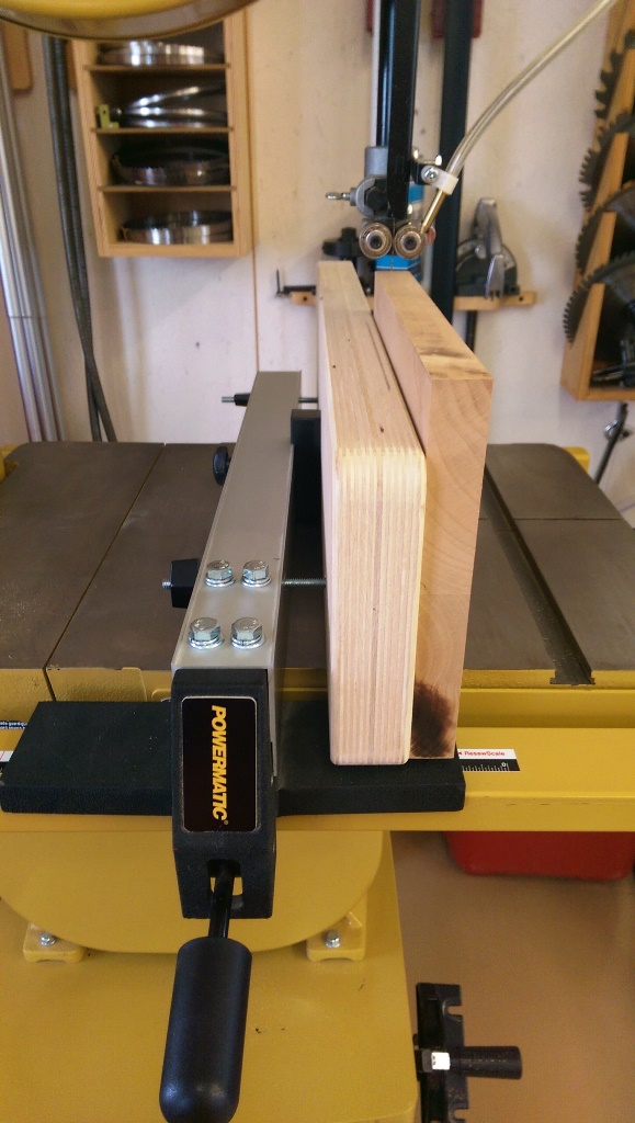

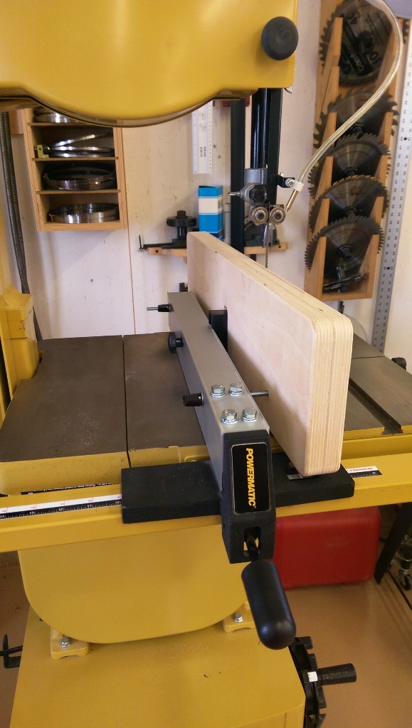

As for blade drift it is a function of the blade. Every blade drifts differently or not at all. The method in the SS band saw manual for setting the fence for blade drift has always worked perfectly for me.
I have a Powermatic 14" band saw that has a point you can attach to the fence so you can manually feed the stock and move it side to side to adjust for drift as you cut. That works but blade drift is very constant for any given blade. Since the Powermatic fence is not adjustable for drift like the SS fence I used the attachable point as a pivot point for an adjustable auxiliary fence. The point is the black piece that can be seen at the center of the fence in the pictures. It works perfectly using the SS method to determine the angle.
Again, a sharp blade is paramount. You don't know how dull your blade is until you use a new one.
