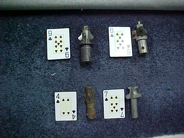

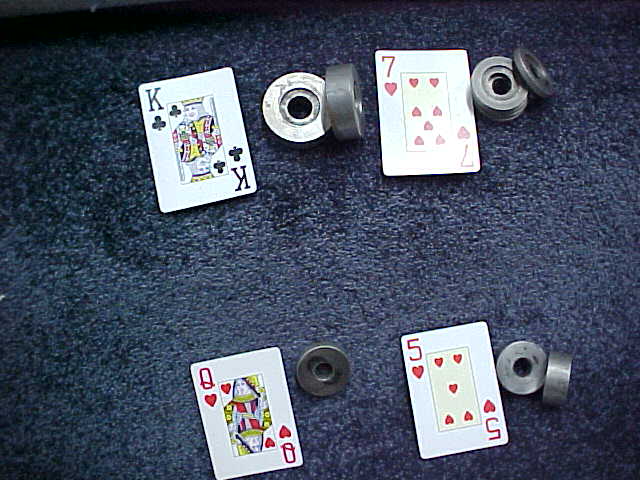

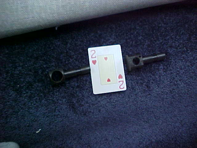

Some of the collars are rather large and would like to know when it would be appropriate to use a particular collar and for what operation. One of the shaper arbors, 9 of clubs is significantly beefier compared to the others. I could draw an analogy to large and small router bits but its the arbor size not the cutter size. One of the shaper arbors has precision laser written on it. Anyone have experience with this type of arbor. It's the 7 of clubs. Any recommendations for cleaning up the arbors? I used table vinegar bath on some rusted items and in some cases, it stripped the finish. I probably left it in too long.Thanks in advance!

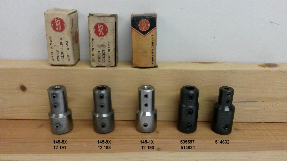

Let's try to make some sense of this for you. Remember the Arbors date back to the Original Shopsmith 5 in 1 Tool, the Model 10E first made in 1947. There is a lot of history there for the Arbors, Spindles and Chucks made for the Shopsmith tools not to mention those made by other manufactures that fit the 5/8" Spindle of the Shopsmith. Some of the items you show are not parts of Shopsmith Arbors, Spindles or Chucks. Others are individual parts of the Arbors or Spindles. I still do not have picture of all of them but will include their information. The first PDF is a listing of all the known to me Arbors, Spindles and Chucks plus some general description information that you may find useful.
The next PDF is a picture and information showing most of the Arbors.

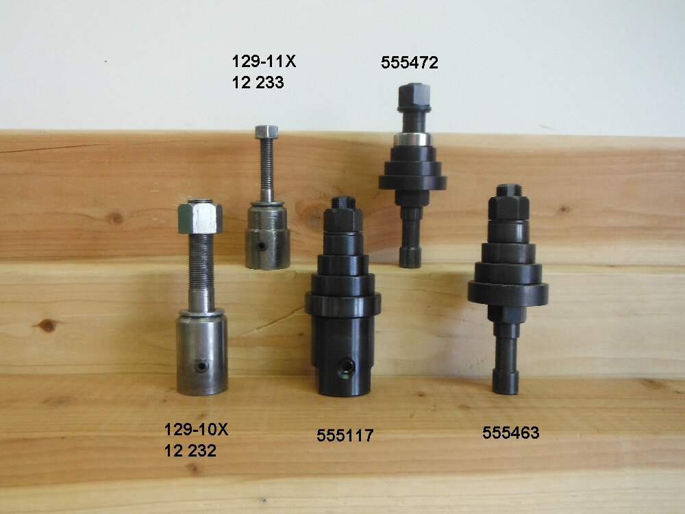

That was only Arbors and does not include the Shaper Spindles. Those are in the following picture.
There were two versions of the early 1/2' Spindles with one having a wider shorter base (not shown) and the other (shown). These early Spindles also came first with a 1/8" set screw and after the introduction of the Mark 5 a 5/16" set screw. The Chucks, not Drill Chucks are generally the holder for the Router Bits and shown below.
This picture does not show the straight sleeve 1/2" Chuck in either bare metal or black oxide coated. It also does not have the 1/2" Eliminator Chuck. I hope this information with the attached PDF's and pictures helps.
In your pictures you show some washers and spacers for arbors (king of clubs & 7 of hearts). These are used with the first Arbors both 1/2" and 5/8" through today with the 5/8" Molder/Dado Arbor (505506) to space and hold different blades or other items requiring an Arbor like the current Molder Head. Theses Spacers and Washers are all machined on one side next to the center hole and the machined side goes towards the blade or other item it is holding. The Shaper Spindles use Rub Collars and has 4 different diameters used for the depth of the cut. Not all of the items you have are made by the manufacturers of the Shopsmiths over the years. I do not recognize what the two items are with the 2 of hearts but they look like some kind of brackets or holder parts. Sorry my best description as I hurry to get this finished. Hopefully you can identify the Shopsmith items you have from this information. If not feel free to ask about specific items.
