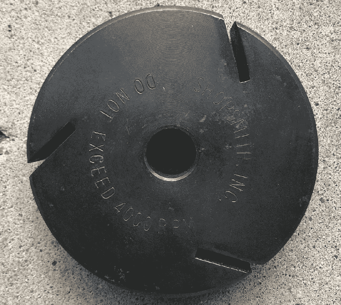

Re: SS Molding Head and Craftsman Cutters
Can anyone tell me if this is the newer head or the older head?
- IMG_0465 Reduced Cropped.png (273.87 KiB) Viewed 14082 times
I cannot say with certainty because I have not determined the difference. I used an unscientific method for determining mine was old: When I bought it it came with cutters, most still packaged. The P/N's for the packaged cutters were old. Leap of faith that it was all bought together inserted here .
Yours looks like mine in terms of marking and does not look like the "new" one shown on line. Still not definitive.
According to the instructions on line the new one retains the ball mount method.

So I think the answer is to measure the slots in the head.

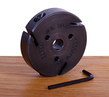

All the older style Shopsmith/Magna Molder Heads have a set screw to attach it directly to the Spindle. I do not believe the new one has that and requires an arbor for use. From the picture (shown below) in the online catalog the new head has three holes through the face of it. None of the previous Molder Heads have those holes.
The one I have, which I think is 'old' and the same as the one in Spooner's picture, has no holes but does have an arbor (505506). Like the one pictured, mine is labeled 'Shopsmith, Inc.' I've measured it and the slots are exactly 0.125. Today I found the pamphlet, it identifies the part as 505553. The pamphlet is dated 9/78. Russ is correct, according to the pamphlet it can be spindle mounted or arbor mounted. That would not have occurred to me, the set screw for spindle mount is larger than those we are used to and it was already arbor mounted when I got it. (This arbor fits the Molder head and the Dado.)
IIRC, you can use the 510/520 lower saw guard if you arbor mount this. For sure, not if you spindle mount it. If you want me to confirm just let me know. The manual (remember, 1978...) doesn't say. Probably good for >99% improvement in shaving/dust control.
