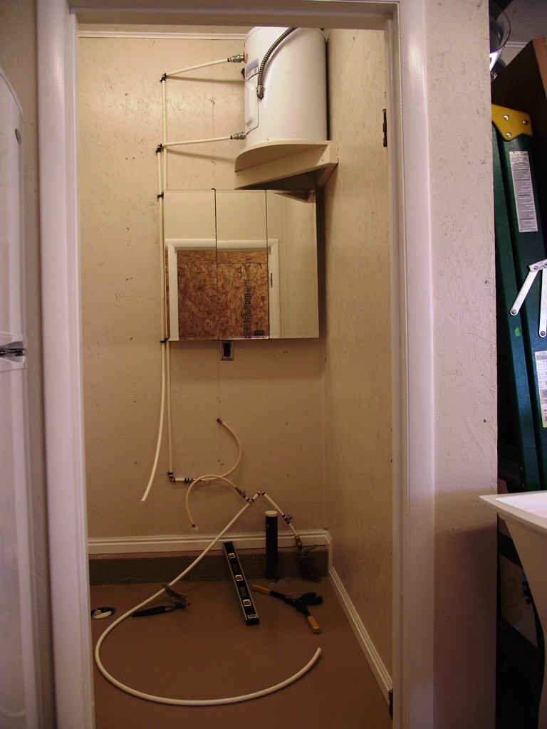

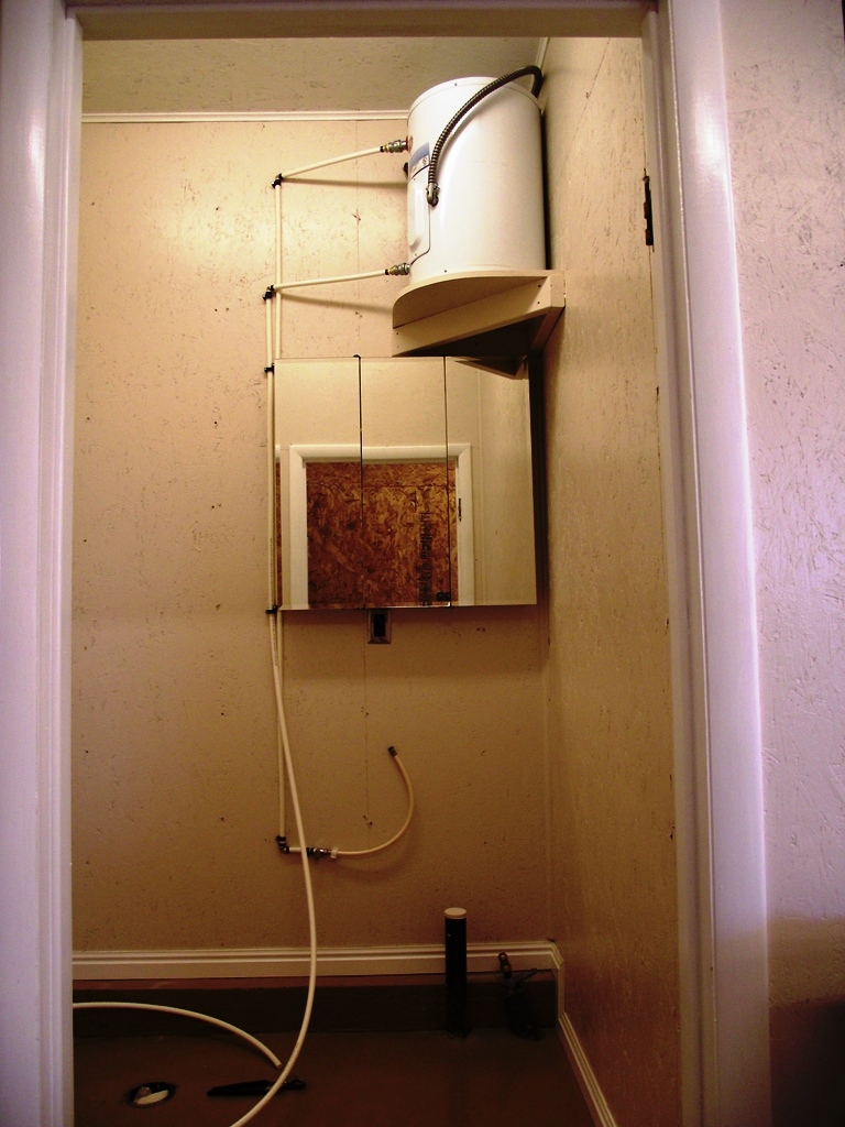

First let me say soldering copper pipe is not hard but you have to learn the technique. Learning the technique is not easy but once you have it it is a piece of cake. It is a matter of understanding how heat and solder flow work together. The same principles apply closely in electronic soldering.
When I built my shop the only thing the contractor did was put up the building shell. I completed the interior. Air lines are 1/2" copper.
Anyhow, PVC is pretty simple. Cut, apply glue/solvent and stick together.

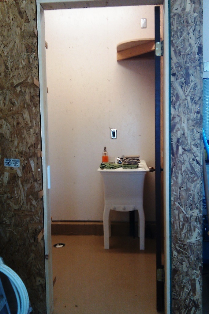

PEX is even easier. I used PEX in the shop bathroom. All water lines are run on the inside of the (outside) wall. Particle board walls, it's a shop. Fortunately at the time I had a friend at work that had a complete set of PEX tools. If you have the tools it is a piece of cake.
I don't heat the shop 24/7 so the two bathroom inside walls are insulated. Of course all outside walls are insulated. I have a 4' electric base board heater in the bathroom. In the winter time close the door and set the heater for 50 degrees and no problem in 10 years.
BTW, that is a 10 gallon hot water heater on the shelf. Not shown is the stainless steel band near the top that is screwed to the walls to hold it in place. It survived the recent magnitude 5.7 earth quake just fine.
