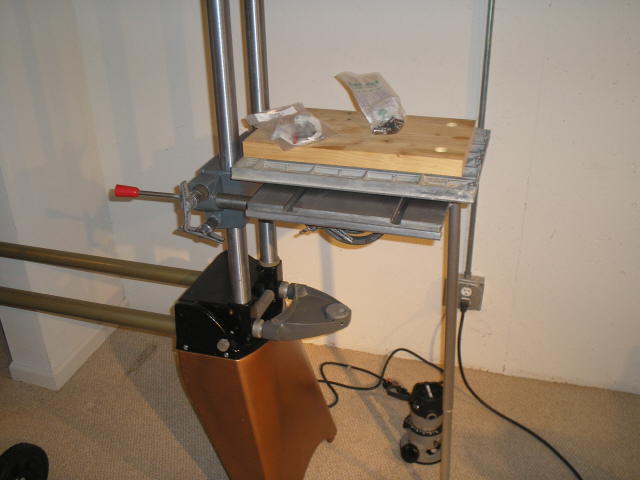

Hello,

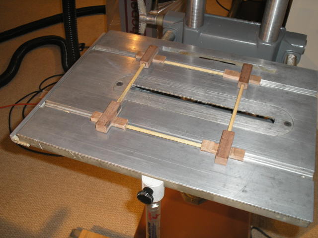

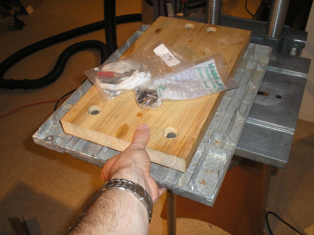

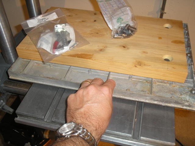

I've been playing around -- getting ready for the OPR I ordered last week. Some inspiration struck and I've got the shards of 2 model-500's assembled into a "compound table," or etch-a-sketch. One worktable is inverted/rotated and fit with a set of mitering grid-pieces over the other worktable.
This works pretty decent in hand trials; I've got the miter-slot pieces just fitted so it's almost impossible to move the top table in X- and Y-axes simultaneously. But in either axis alone, it slides just so.
I am thinking when I want to do some special routing jobs, I can put stop blocks around my top-most sliding table / "block", and go to town. Of course with the hold-down clamps and inserts I've bought, I'll be able to put my workpieces on the "block" at arbitrary orientations.
Photos attached....
Enjoy!
