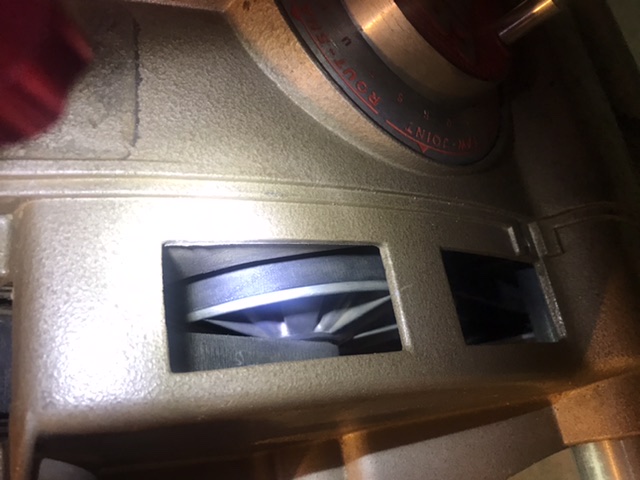

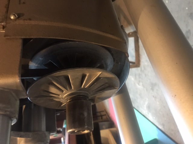

Re: Shieve/belt issues on 500 Goldie
Some pics. I am pretty sure I did oil the motor shieve. But all advice much appreciated. Thanks.
- AC28495F-E477-4B4B-A47A-C0D805FCC617.jpeg (63.72 KiB) Viewed 10681 times
- 3352CA8F-55DC-439B-A016-E5CC1A75E871.jpeg (81.48 KiB) Viewed 10681 times

- Posts: 35598
Now WTH is the third pix? It ain't the same parts as the first two.
DUH!
Of course not. It is of the back side of the control sheave. Looks strange, Is that the belt?
Note that looking directly into the pulley the high spots on the (usually) floating sheave should align with the low spots in the fan sheave. This is controlled by a key, so probably correct, but the pic makes it look off to me. I'd make sure that it is aligned before tapping it very hard. If it's off it would suggest the floating sheave is somehow off the key, which is hard to imagine. But otherwise consistent with symptoms as I understand them.
- Posts: 35598
With the belt off, it should be easy to determine that.(looking from the bottom of the headstock)
