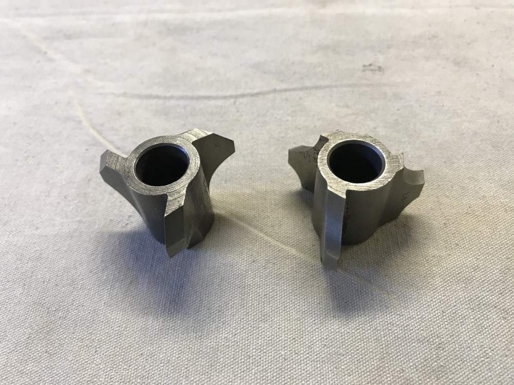

Re: SS Shaper Cutters
In the picture below are two Shaper Cutters. With the top going toward the Headstock the one on the left runs "forward" whereas the one on the right runs "reverse" and would require a reversing headstock like the Mark 7 or VII. These are both SS Shaper Cutters just one upside down from the other. It is simply the Shaper Cutter's orientation to the headstock that needs a clockwise or counter-clockwise rotation (reverse or forward).
