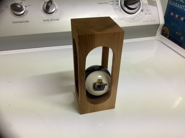

I was bored and had no projects in line so I decided to make another, but larger golf ball in a block, but this time for a pool ball in a block.

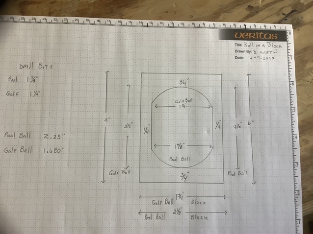

soak a soft wood in ALMOST boiling water for 5-10 minutes then push through. Search internet golfball in a wood block. Size changes for pool ball. 1-3/4 Forster bit for this pool ball. 1/4” sides of opening. See my attached attempt at drawing plans.bainin wrote:How in the world did you fit that fat billiard ball thru those tiny slots !
- 64D11C50-4D5F-45E6-9023-12EB8BDB10E2.jpeg (105.7 KiB) Viewed 11948 times
Re: Bored
Why "almost" boiling?
Re: Bored
Don’t know, just followed the instructions I found on the net!JPG wrote:Why "almost" boiling?
The first one I made of a golf ball I made with padouk and it being a harder wood I had to leave it in hot water for a looonnnnggg time.
A Marine I follow orders!

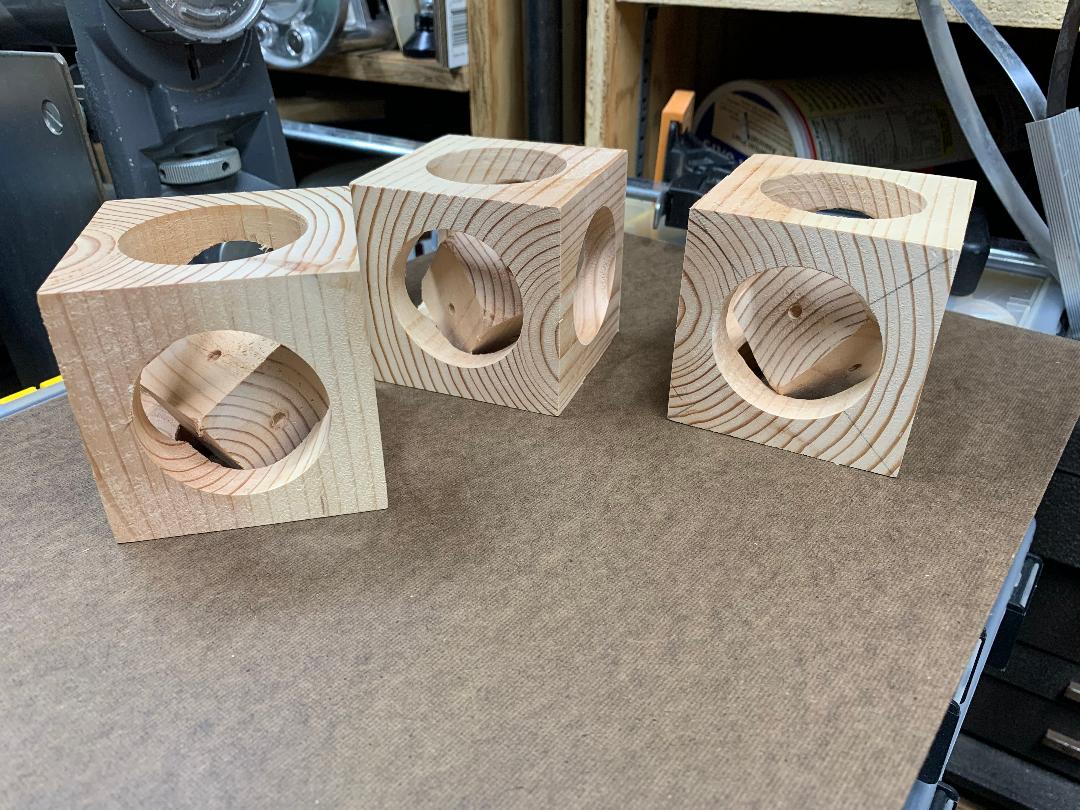

I started on a golf ball version a couple of years ago. This is as far as I got:
Now I have to find the rest of the plans to be able to make them. When I dug the blanks out I also found these:
I made a batch but these have not been finished yet. I don't love sanding so I know why they are still in this state.
Guess I will never get everything done but it would be nice to finish off at least a few of these projects.

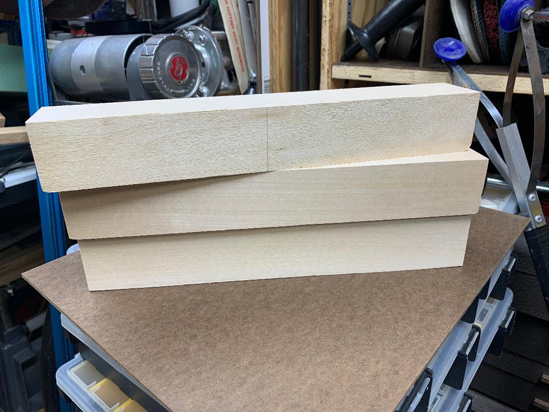

Well Ed I went ahead and did it. I broke the pool ball out of the holder and went ahead and drilled out a 3”x3” cube and have it soaking and will try after the appropriate time to get it in. I have jury rigged a vise (sort of) to press it in at the appropriate time. I will photo and post, if it works.
