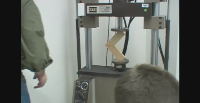

Well, I have seen plenty of these joint strength tests online now and it seems like all of them have wildly different results...so much so that my head is spinning from all of them. Full disclaimer, I do own a Domino, but I will try not to let that bias my thinking. Has anyone watched the video that accompanies this article (see link below)? Unfortunately you need to be a FWW subscriber and have online access to their site. I was really quite disappointed when I watched this video. So, the basis of the test is they are trying to assess racking forces for a face frame joint like what might be in a face frame, door cabinet, etc. So, they milled up some cherry that they are joining to create an "L". Imagine this "L" shape being rotated 45 degrees and put under a vertical hydraulic press. They cut small 45 degree corners on the two ends so that this "L" shape sits at a 45 degree inside this press...just resting on the bottom plate. Then they lower the press until the joint fails. There is no kind of test fixture or other method to hold the joint under test into position (so it could easily slide around under the top plate of the press). I am not a mechanical engineer, but from what I remember of my statics and dynamics classes this doesn't seem like a good test methodology to me (for consistency of test results). I could easily see the translation of the normal forces being transferred into the joint under test varying quite a bit between each one being tested. I can see why the biscuit performed well with this type of test because of the direction of the forces and the biscuit is basically acting like a spline for this test. However, comparing the Domino (loose tenon joint) to the basic M&T makes no sense at first glance, but then you have to consider the way the joint is being tested. As Dennis pointed out you could easily put 2 tenons in there and I expect if you did the Domino would perform closer to the basic M&T performance which is what one would expect. Half lap and M&T have a hug advantage in glue surface area in the planes affected by the forces from the press. Also, I am sure they used Beech tenons for the Domino testing and they sheared off completely in the video showing the tenon was the weak link. Personally, I don't exactly consider Beech a hardwood, so I would be curious to see how the Domino joint might fare with different wood species tenons.

The thing I took from this is that when using anything dowels, dominos, tenon, the distance they penetrate into the 'stile' determines the stress location(that is where the stile will split. I assume the longer it is, the stronger the joint. So a thick through tenon seems to be the strongest. I do not think they tested that.

JPG wrote:The thing I took from this is that when using anything dowels, dominos, tenon, the distance they penetrate into the 'stile' determines the stress location(that is where the stile will split. I assume the longer it is, the stronger the joint. So a thick through tenon seems to be the strongest. I do not think they tested that.
Thanks JPG. I guess you are right. When I first looked at the photos of the Domino failed joint, I thought it was closer to the edge of the board (where the two boards meet), but looking at it again now it does look like the split occurred essentially where the Domino tenon ends. This is similar to the beadlock and dowelmax failures. Thanks for pointing this out.
