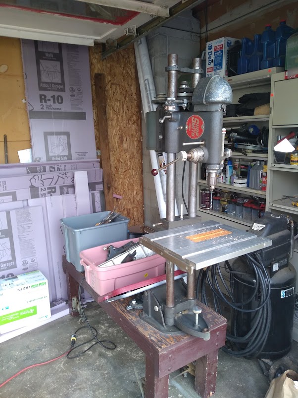

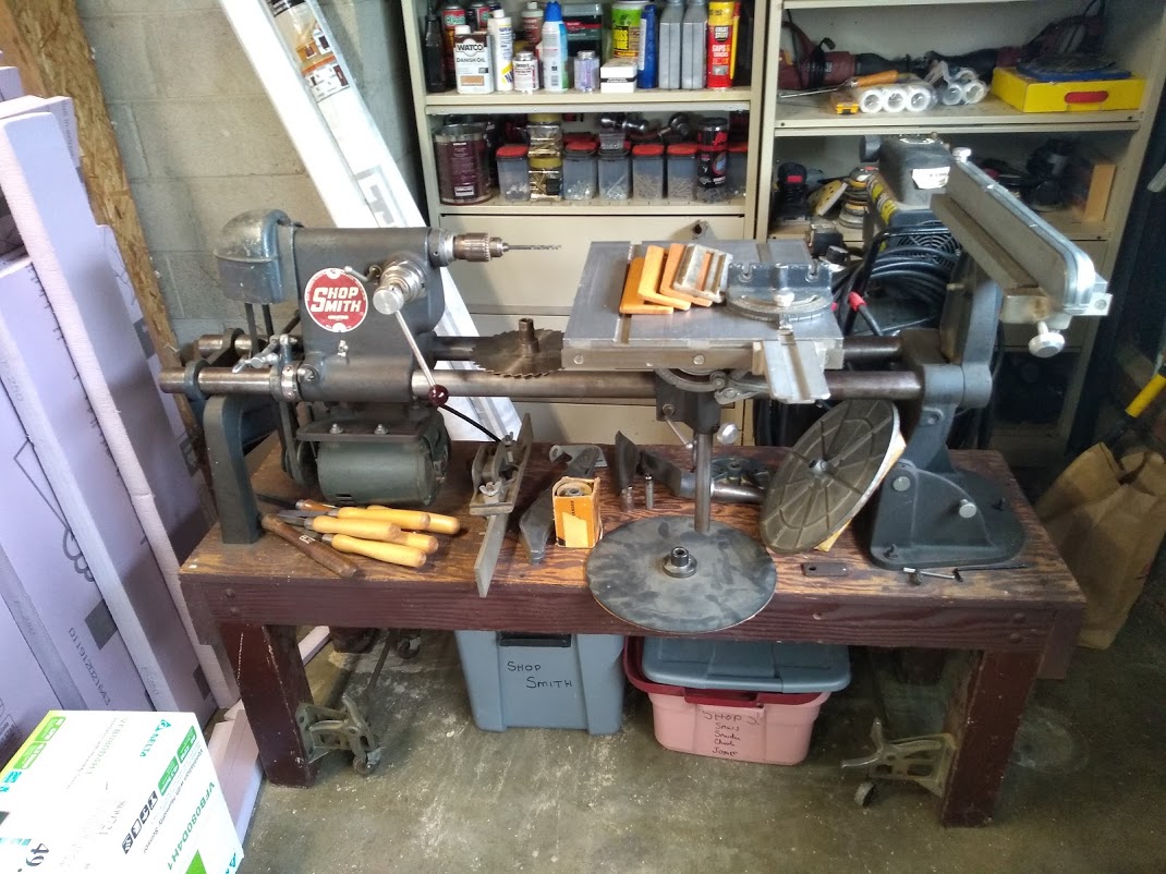

Serial number 78555, no prefix. Pictures attached, I think. I'm a secondary math teacher and I'm hosting a technology and distance learning training in 35 minutes, but these forums never work the way you anticipate!
Edit:
Pictures can be found here, I don't feel like taking the time to scale them down to 2M right now...
https://photos.app.goo.gl/ebDHnHCSZBZU5JVk9
The guy I bought this from went with his dad to pick the machine up new from Montgomery Wards in Fort Worth TX, 1953. His dad was a doctor and he was a dentist. Aside from hobbyist use its basically pristine considering it's 67 years old. I was pretty happy to give him the full $300 he wanted for it.
My dad had a 10ER in his shop that was only ever used as a giant drill press (don't know the serial number of that one--it was gifted to a small cabinet shop owner as dad moved and downsized). I feel a little bad about how it was treated looking back, but I've wanted to add one to my shop for quite a while.
I've already dived into most of that material. Really appreciate that the community has put so much of their time into making it available and preserving it.

Photos from link
