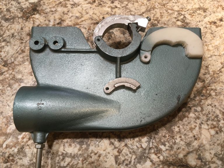

I think this might have came with one of the Mark VIIs that I bought some time ago. It was not originally green. If anyone has one of these or a picture of one could you share a photo of the area where it latches to the lower half of the guard. I have made a couple attempts at this but I only have half of the part needed. I would like to make a pattern with wood and then pour one from melted aluminum.

I poured an aluminum copy of a wooden mock-up. As rough as it turned out I might as well have done it on the Smithy mill to start with. The part was hard to hold in the mill vise but I ended up with a reasonable facsimile that does work. Thanks again Russ.
Still have to get a hex head socket screw next trip to town.
