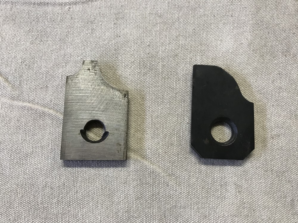

Below is a picture showing the two styles of the "Old" Knives.
Molder Knives.jpg (327.81 KiB) Viewed 4934 times
The one on the right is the original style having a smaller hole with an additional "cut" out at the bottom of the hole. The first Molder Head held the knives in place with just screws and the "cut" out was for them. The second "old" knives had a larger hole that the ball bearing sat in to align and lock the knife in place. These will work in each others "old" Molder Heads
