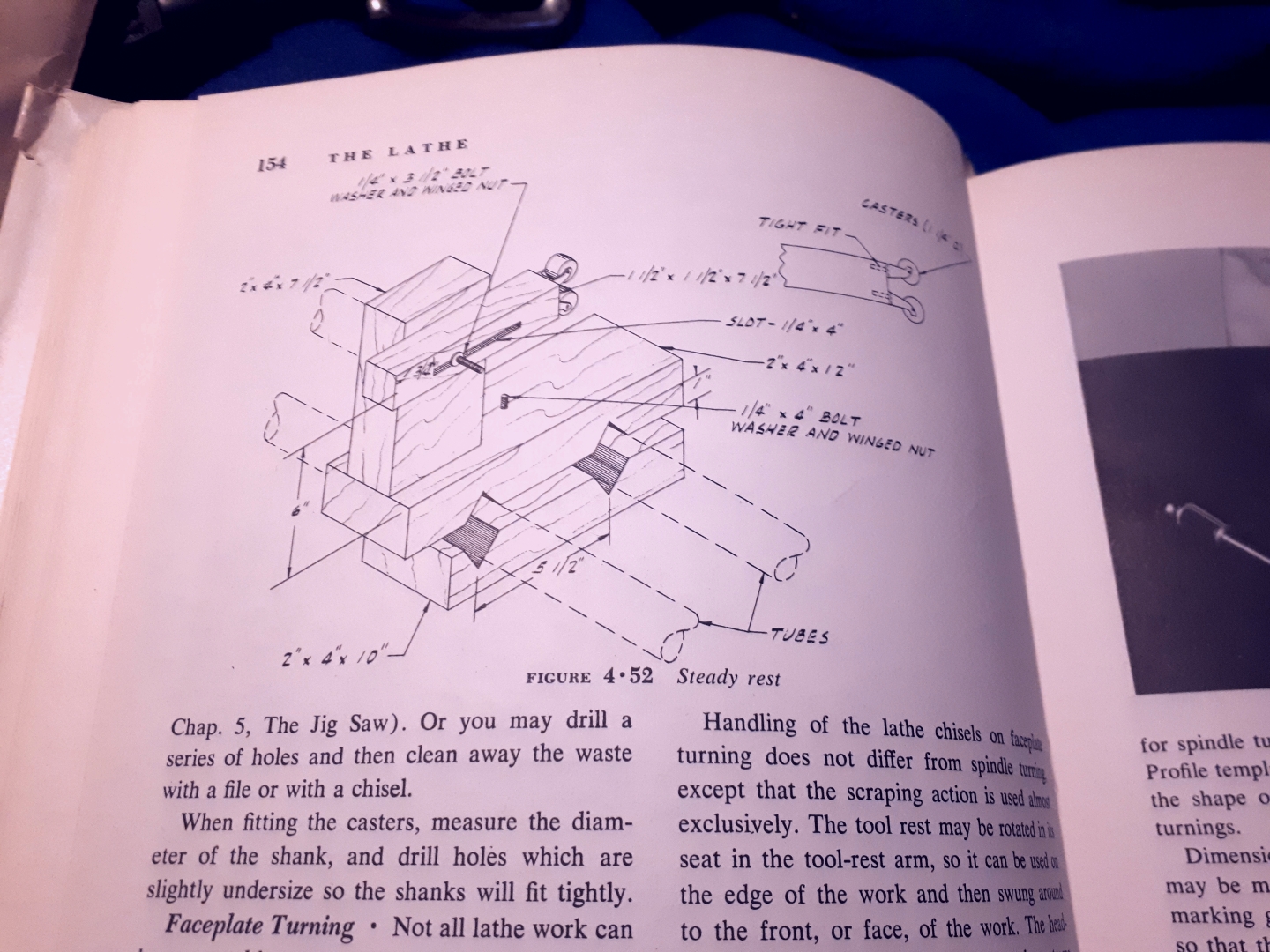

There is one in the Power Tool Woodworking For Everyone, 1st edition.

Re: Steady Rest
Interesting. I guess I could add a second arm opposite .

Re: Steady Rest
Shopsmith sells one that fits in the rear hole on the carriage, Could be an idea there.
