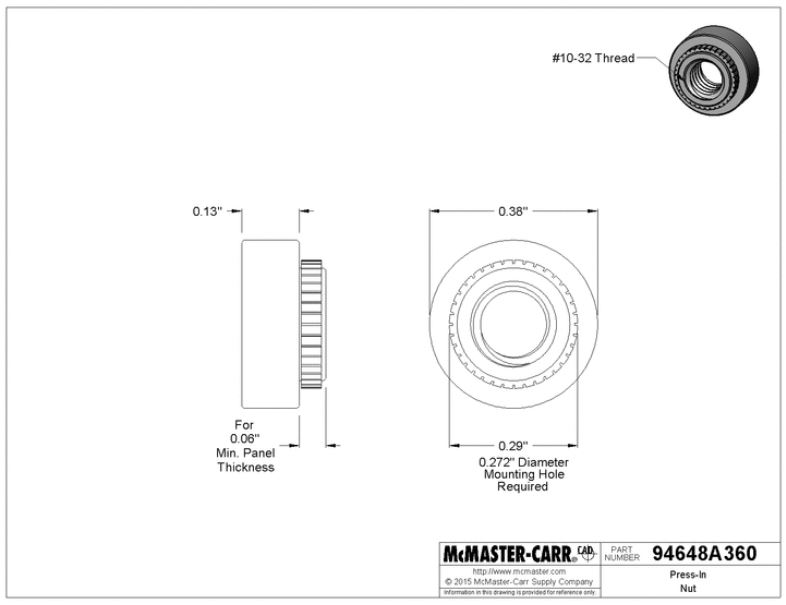

Anyone know the screw sizes for the speed control mount? Mine stripped out. (e.g. "#10-32 tpi, 1/4 inch". Pic below:
Re: Speed Control Mounting Screws
I believe they are 10-32. epoxied kep nuts on the back side MAY work if they would not interfere. The kep nut lock washer helps the epoxy grip them. Getting the epoxy to grip the casting is less effective. I would NOT enlarge the holes. Larger screws would require enlarging holes in the speed changer/spring. Since this is an "A" casting, simply using nuts is possible since access requires getting there from the open 'bottom' anyway.
I can't confirm the 10-32 size, but it occurred to me that you could install press-fit nuts from the backside. Instead of using a press, you should be able to just use a screw and washer to draw the nut into the (enlarged) hole.
The last set I removed, 2001 headstock, were 10-24TPI, 7/8" long pan head. They were Phillips. I'm less sure that much older ones were the same but with slotted heads. Originals are thread cutting type, but I'd think that is for faster first time assembly.
