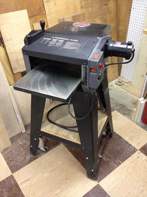

That’s the model number of the feed motor. Shopsmith planers all have a separate drive for the feed rollers — either a variable-speed DC motor (with an AC-input drive) like yours, or a hand crank.
The cutterhead is powered separately. On Mark V mount units, the cutters are normally powered by the headstock. However, they can also be converted to stand-alone operation by mounting them on a powered stand, either home made or purchased from Shopsmith. Given that you are contemplating mounting it on a flip-top stand, I suspect that this is the type of planer that you have.
Below is a picture of a Shopsmith Pro Planer, which was shipped from the factory already set up for stand-alone operation. It has a 1-3/4 hp cutterhead motor, mounted on the understand of the stand.
