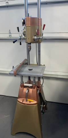

That being said I made my dedicated drill press from the 18" tube pieces I cut off to make the shorty. I put the base together in the normal way but reversed the head stock and carriage on the way tubes so it sits over the base. It is rock solid.
- IMAG0236.jpg (179.8 KiB) Viewed 21750 times

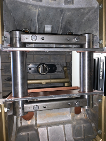

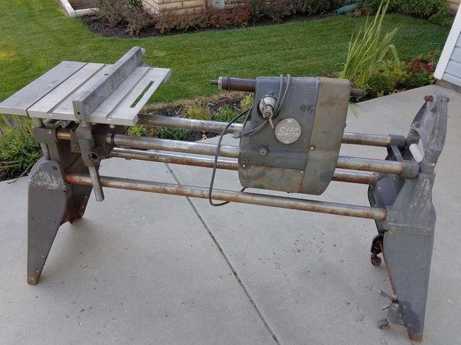

I used jsburger's design concept when I made my dedicated drill press. Since I was using an old model 500 table I found 18" bench tubes were too long. After playing around with several different lengths I settled on 9 1/4 inches for my tubes. I found this length allowed me to have the back of table next to the way tubes while at the same time placing the front edge of the table over the "support tubes" (also copied from jsburger's design).
- I Started with this "train wreck"
- 25 dollar shopsmith.jpg (59.27 KiB) Viewed 21855 times
- This is what I ended up with
- Dedicated Drill Press- Goldie.png (236.34 KiB) Viewed 21855 times
- Front View- Dedicated Drill Press- Goldie.png (195.62 KiB) Viewed 21855 times
- underside view of the Bench tubes
- bench tubes cut at 9.25 inches.png (477.77 KiB) Viewed 21855 times
